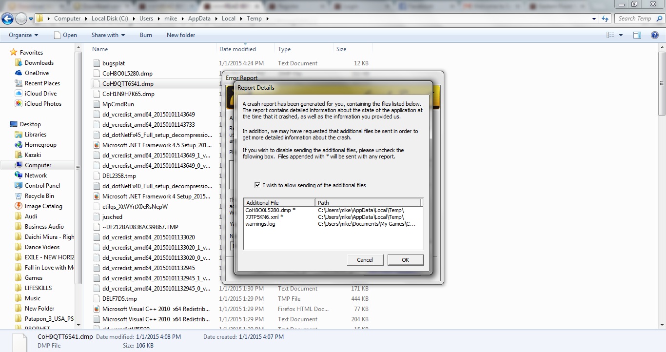

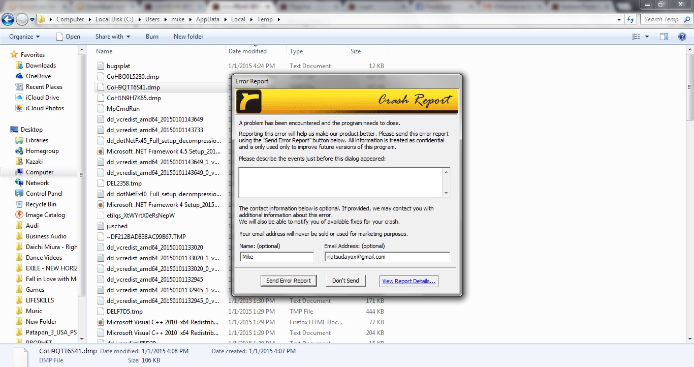

Copernicus wrote:
We figured out the TEMP Folder Full Error.
See here for more details.
Please include the following files:
*Documents/My Games/Company of Heroes Relaunch/warnings.log
*Documents/My Games/Company of Heroes Relaunch/LogFiles/scarlog.[Date-and-Time].txt
*Documents/My Games/Company of Heroes Relaunch/LogFiles/ailog.[Date-and-Time].txt
*Temp/RandomLettersAndNumbers.dmp (see below)
How to get the DUMP file
  1. Hold Windows Key and click R
  2. Enter "%Temp%" (without " " and with % %)
  3. Find the .dmp file that was created at the time of the crash

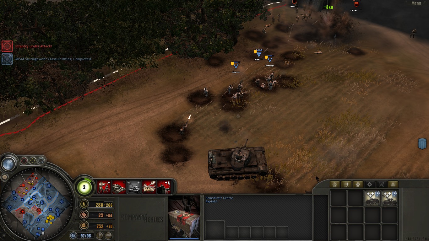

I found this while playing. Are the bonuses for the grenadiers not available or just aren't visible?
#154838
Re: [2.300] Game crashes/freezes - Post here
The bonuses are never visible, the vet marks are though ;)... we did a mistake and the Grenadier vet marks are weird, but the bonuses remain the same. It will be fixed for the next patch.

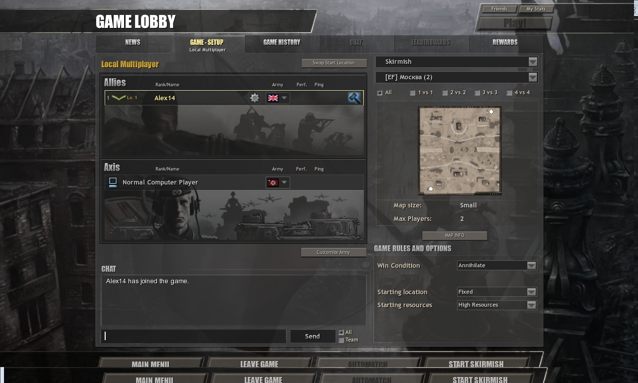

#155540
-- Log file for all dbTracef messages --

#155819
CRASH REPORT ERROR
Hi,
I just installed Company of Heroes Anthology in my computer and when i tried to open it for the first time, it shows a crash report immediately. I have already disable my antivirus and firewall, installed the latest directx version, install all version of net framework, install all version of Visual C++. I am still getting the error when i tried to open it again. My Computer Specs is uploaded in the Dxdiag.txt file.
I have also screenshot the error for reference and also uploaded the following files:
1. Warning.logs
2. CoH8O0L5280.dmp
Please advise on how to solve the problem, Thanks!
Hope to hear from you all soon!
