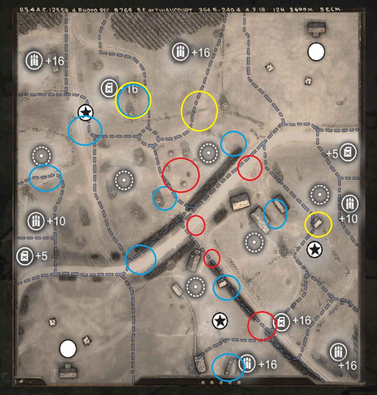

#116560
Re: AI Bugs Discussion
Also if AI could put mines at choke points it would help. ATM AI only puts mines near strategic points.
jojorabbit wrote:
GAI002 - all factions build more mines then before
Im assuming you just mean they will make more mines rather than put them in different spots ;)

QuoteAlso if AI could put mines at choke points it would help. ATM AI only puts mines near strategic points.
It could on the roads.
#116563
Or like on Angoville and Langres where there are nice little hedge grove choke points. Or even on the other side of heavy cover. When the enemy tries to use the green cover: SPLAT!

QuoteGAI002 - all factions build more mines then before
I mean they build them more often ATM.
Yes ATM AI builds mines by one mine near strategic points, also AT mines by one near Strategic points.
By minefield i mean for example 5 mines in row close to each other like in line/vector but leave that for later.

#116575
You programmed the AI to make a minefield? IMO they should not put mines in a line. Vehicle that's out of control could run them all over. At least space them a bit from each other
#116578
QuoteYou programmed the AI to make a minefield?
Yes why?
Well IMO spacing is also possible but only for mines, tank traps and others should not have big spacing.
#116580
I think The AI putting a line of mines in a row is a good idea. It will only have to hit two squads and there will be more player minesweepers and less Flamers.
Cat Fishy do you have any ideas on how to get the AI to rationally design and layout a minefield? If you can describe it in words JoJo can program it. :)

#116592
Obviously no. That's why I'm suggesting this to him ::). And IMO having 2 mines near each other is fine but having like 4-5 is just too much. A mortar strike or a out of control tank could just trigger everything. Also keep in mind the AI needs to buy and do other things too like flamers or Bren guns or uses grenades or abilities like over drive or suppressive volley. YOu only have so much muni.
#116594
Probably the mortar could trigger them but if you drive on the road for example and there are 5 mines puma is done with first 2-3 mines and there are 2 left :).
Yes i know AI has to buy things with muni but i noticed when testing AI almost always in middle game AI has a lot of muni and does not spent a lot of them.
#116599
As long as you know what you are doing and testing it :P. I still think 3 mines is a good number rather than 4-5
#116601
Cat wrote:
Or better make it random 3-6 max mines in row?

Ok, can anyone draw me a good vectors/spots on angoville farms so i can test it. Focus on mines for now leave other defences for later.

I took a picture of Angoville (ty Google :)) and added little circles. IMO these are okay spots (although I wasn't 100% sure what was there so you might have to look for the heavy cover or the choke point my circle refers to :-X). The circles are color coded. The circles can work both ways (ether starting pint) but is slightly more oriented towards the south.
Red: Priority
Blue: Later on
Yellow: Low Priority
#116665
Thanks for start i will try a red ones later will see.
