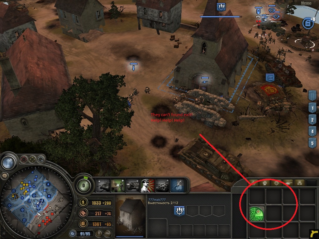

Re: [1.601] List of known issues
Spotter team cannot get out from a house. They have not an exit button. Please fix it. Pic:
#109186
I think they have, but the icon of the spotter ability is above it  :-X
#109188
You can right click the unit portrait to exit buildings.
