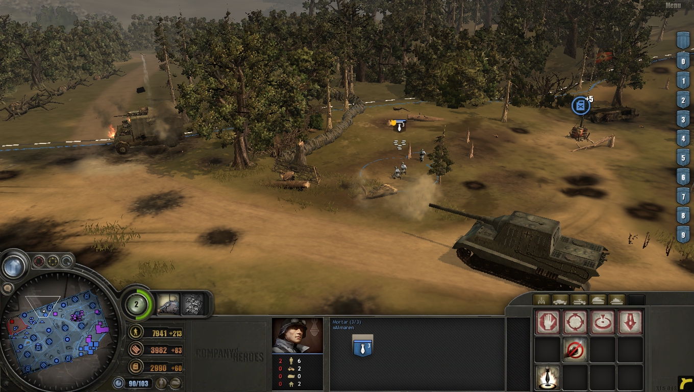

While playing EF on the latest patch, i noticed this two issues:
1. American captured by PE mortar hasn't got the smoke barrage abiliity (is this intended?).
2. There is a chance for the Jagdtiger to bounce shots on the British command truck.
Here's a picture from one of the shots that bounced while it's in mid air and the captured mortar.
#118440
Re: [1.610] List of known issues
Thanks for the feedback.
The mortar thingy happens with every faction but amis.
I'll check the British Command Truck, but this is normal for any tank gun. When locked down CW trucks get additional protection because they act as buildings not as vehicles.
#118498

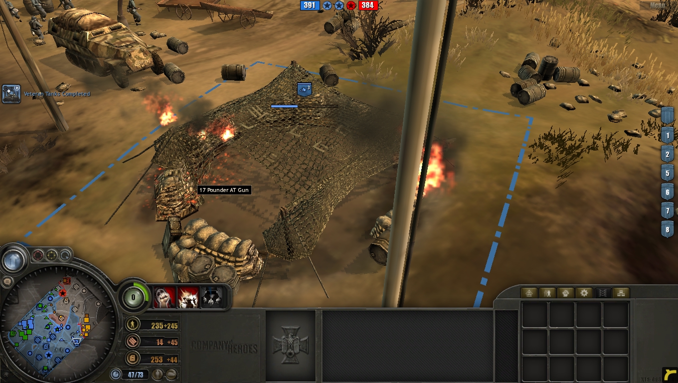

Captured by Wehrmacht 17 pounder emplacement lacking the AT gun.
#122547
You seem to use a skinpack, please disable it in order to test if the AT gun is still absent then.

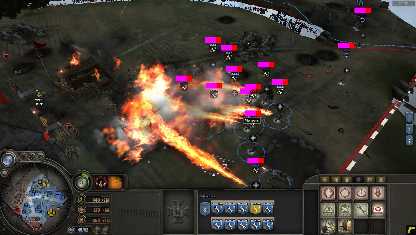

There is an issue with the ability Inspired Assault. When you use it, little pink boxes appear.
#124152
Already detected and fixed :P(see first post)
