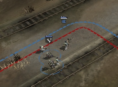

i was just playin an AI match and noticed that when the AI hulls down their zis guns they dont seem to know how to undo it, They just sit there picking it up and setting it back down. this includes enemies who recrew a dug in gun.
image hosting jpeg
#86970
Re: [1.501] List of known issues
They also lock down in some fairly dumb spots. Not all the time though. Maybe AI shouldnt' be allowed to use it :P

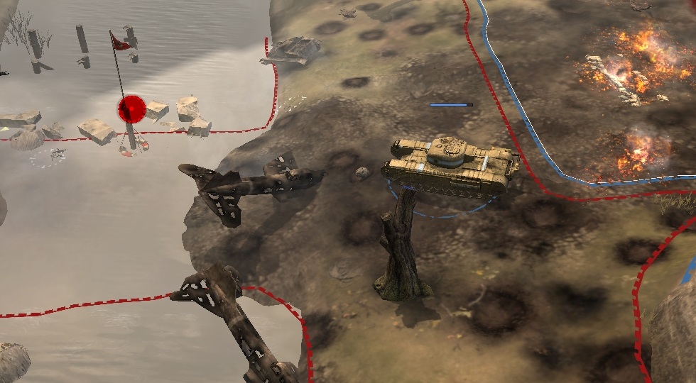

I also caught this and thought it was pretty interesting
That's normal. Veterancy is achieved by combat in game-Fortress mode.
