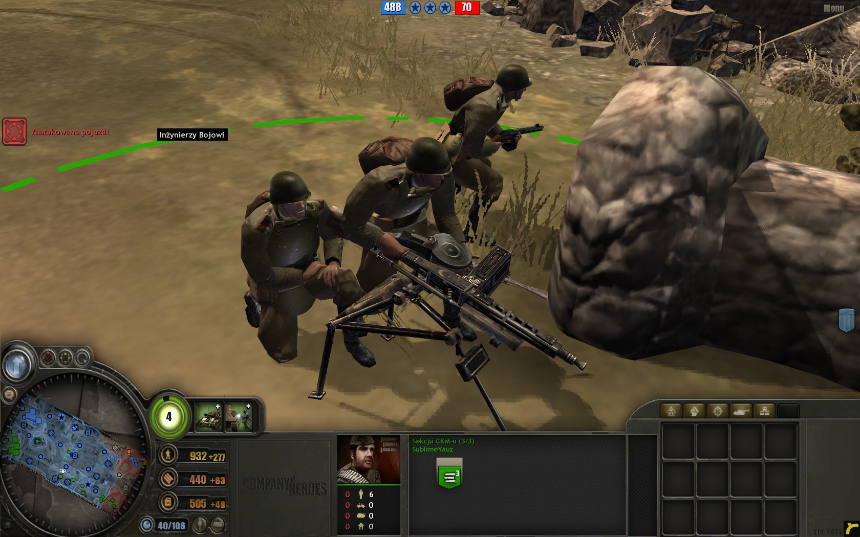

- PTRD animation is bugged when a grenadier using an MP44 picks it up.
- Sturmovies are bugged when capturing heavy weapons and shows a DP-28.

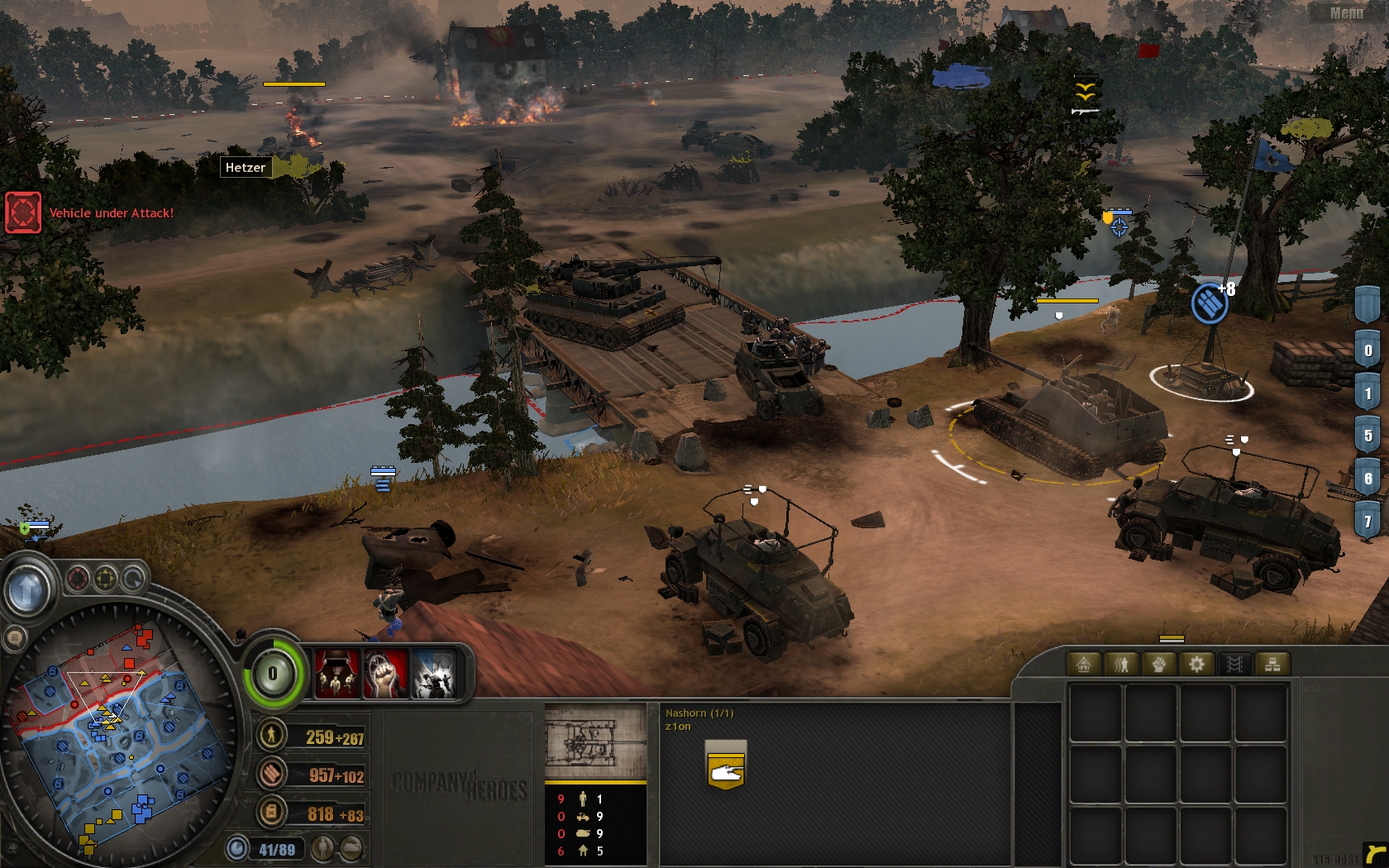

i played one match today with another player against AI to test the new units.
i was WM and my ally was PE (he chose luftwaffe). after some time we had connection problems and he dropped so the the AI took over for him.
just about 2 min later he was using hetzers :o (which would mean tank destroyer doctrine) but i'm sure he took luftwaffe cause he already had fallschirmjagers, luftwaffe groundforces and nashorn as well as the flakvierling. might not be an EF bug, just wanted to mention it, maybe someone experienced the same  ???
about the screenshot: it is a 2v2 map. you can see a nashorn, fallschirmjagers and the hetzer.

The PTRD does not properly replace the SVT on the Naval Infantry, both guns are visible in use.

Also, i'm sure this might be completely unrelated to the mod, but I was playing the PE campaign on Return to Valkenswaard when I lost both my Jagdpanthers on a bridge (forgot it was booby trapped, camo on vet looks great btw), and two squads of 2-men dubbed "Tiger Crew" spawned after they blew up, they all had the proper abilities of the ones from Tiger Ace DLC :o
Regardless, it may have been a random occurrence since my internet connection fell while playing it (and it did freeze for a few moments, twice.)
I tried it again to see if it was a random occurrence and killed a Jagdpanther on purpose, and it pretty much happened again, so something's up, I'll need to check on MP.
Before
After
#71750

Thanks, i didn't notice it before. Will be fixed for the next patch XD.

-The map "Battle of Mahiljou" has 4 salvageable wrecks. 3 of them are American p47 thunderbolt which give about 75 ammo each. The wrecks should be changed to Henschel...
-I saw a soviet MG crew (out of a MG dogout) running around in a AI game. Then I found a empty MG nest near their base...

Re: [1.4] List of known issues
QuoteCW
- MG crew (out of a MG dogout) running around in a AI game. Then I found a empty MG nest near their base...
That's not a CW bug it's for the soviets.
