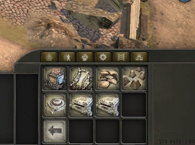

Re: [1.510] List of known issues
For some reason Pioneers have the option of building 2 bunkers :P
#101620
Side effect of the christmas patch, the other should be the christmas tree IIRC.

Re: [1.520] List of known issues
Dunno if this has been already reported but in Wehrmacht Pios have found this: Two Bunker abilities for Wehr Pios.
#105471
Second one is the Christmas Tree and it was removed already ;)
