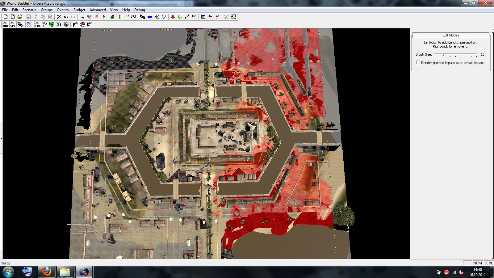

Hi, I have recently found a map me and my buddies used to play constantly (pre v1.7), the map stopped working when opposing fronts came out and we have sort of forgotten it:P Now that im trying to make it playable again i have hit a snag:
Only half the map is usable?
When i draw an impass map, one half of the map is red, and the rest is black, on the red part i cant run/drive or anything like that in-game. I have tried to use the impass map editor to "right-click" it all away, but it has a different color when i add some land impassibility, and when i right click the red parts, nothing happens...
So, any ideas?:)

I suggest to stamp the whole map.

Stamp with what? and where do i find it?:P
I have to admit, im not a seasoned map-editor, so just be as specific as you can:D
*edit*
I added a pic if its any help.
*edit*

Here you go! The starting-points are a bit random atm, the original map had them in the holes in-between the buildings, but they bugged on startup, i have also removed some objects to ensure there is room for all the buildings!

Just like I thought. You used following object which has a bugged impass area around it and causes severe lags:
You can download the updated version here

Re: Noobish mapping questions post here
Awesome! Thanks mate:)
As I said, all I have done on this map is to add new starting points, but now its time for us to take it for a spin! Thanks again;)

Ok, so I took the original map, removed the objects you marked on you previous post, (+changed the outline of some zones), but didnt move anything else... If i now host a annihialate(?) game it starts and works as it should, if i start a victory point game, it becomes a annihialate(?) map when the loading is done.
So.. I guess i have fixed whatever i accedentaly broke before:P
Cheers!
