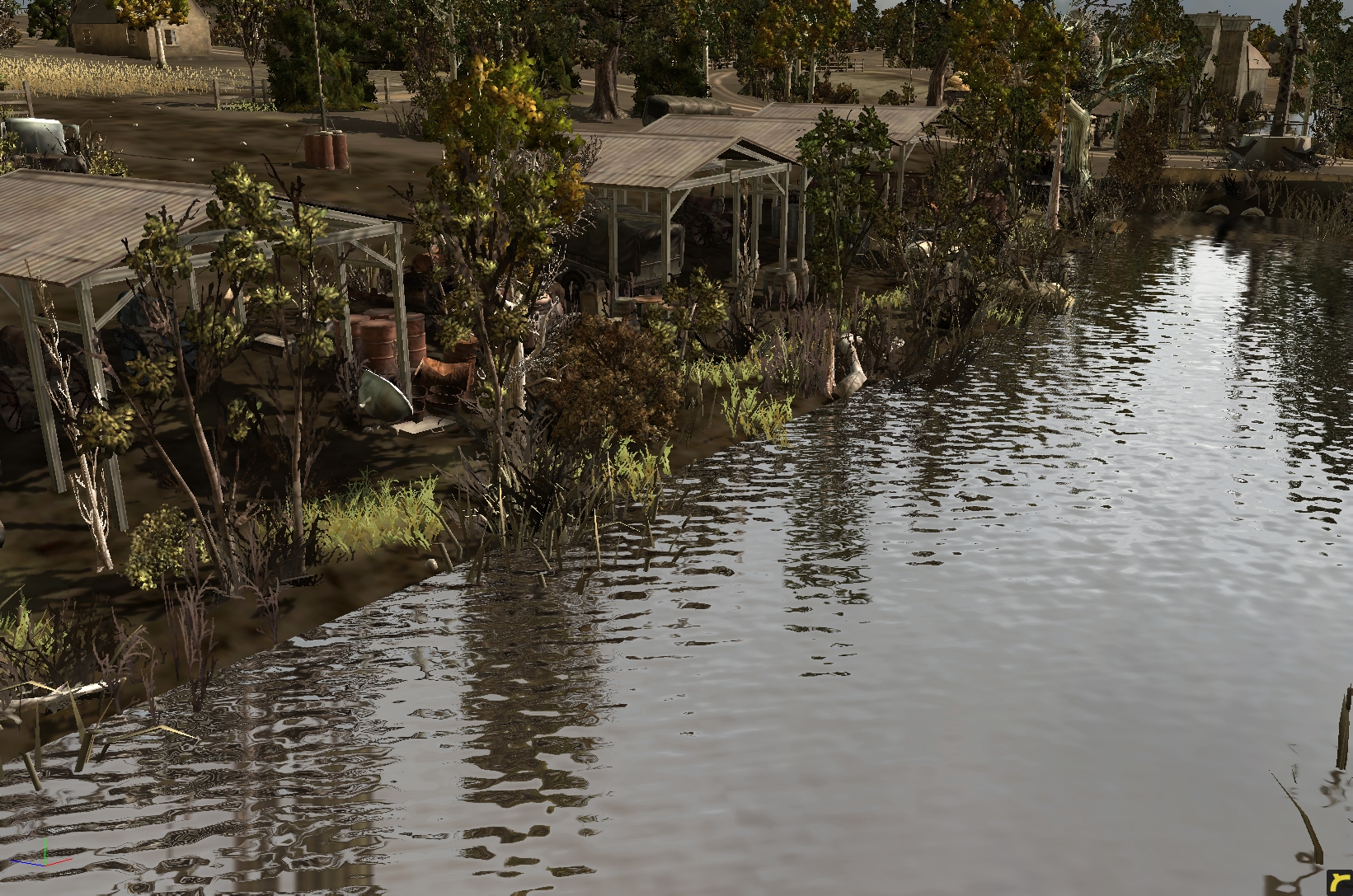

Working on a map for y'all. Kolkhoz 17. Trying to figure out how to post screenshots (never been much of a forum poster). Interest in new maps?
