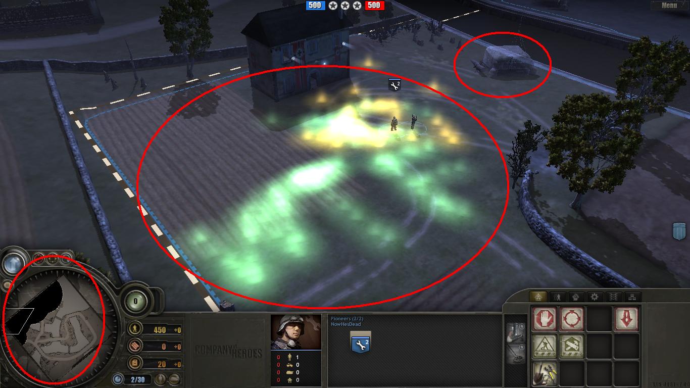

Game freezes
I've tried to check if anyone is experiencing the same freeze as I am, and I havn't been able to find any mention of it:
The game doesn't crash, it just freezes, doesn't matter what faction/map I play, when I start the game, it loads halfway, freezes for a while, then a little while later it will load the rest.
Then, as soon as you get out of the loading screen to the actual game, it just freezes. I can move the camera around fine, click on units/buildings, command trees, but otherwise the actual game is just frozen.
It's just like when you play online, and someone turns of their connection, it freezes in the same sort of way; you can click on units and stuff, but the game itself has paused.
Nothing else happens, it doesn't crash or anything. I've tried to play online with one of my friends, and it kept on asking me to kick him and vice versa.
I've uploaded a screenshot with this post.
#73756
Re: [1.4] Game crashes/freezes - Post here
It's the map Leningrad and it's bugged at the moment. Already fixed will be included in the next patch I think.
