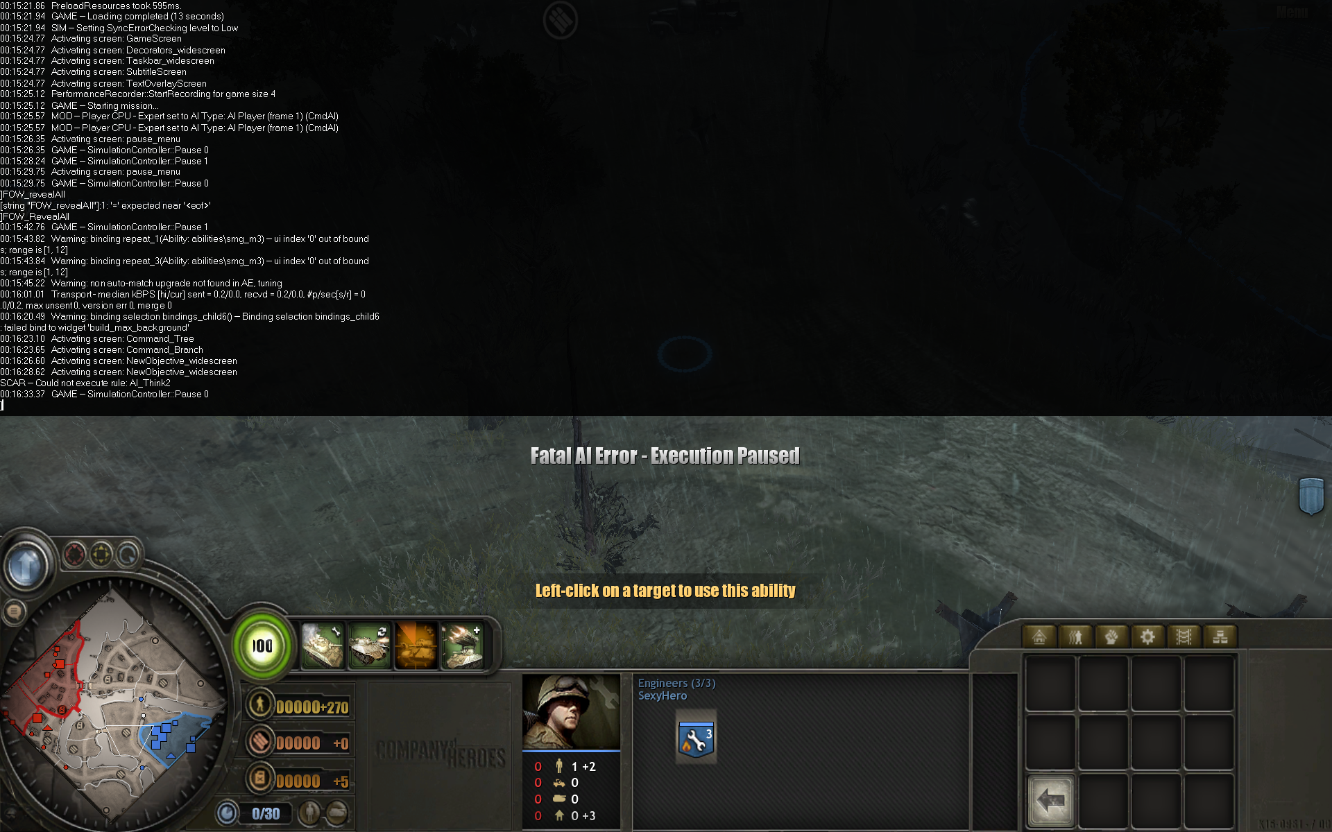

Hi Jojo I finally had time to test it but midgame it suddenly said fatal AI error - execution paused again.
I checked console and I think it's from the error that says "SCAR - Could not execute rule: AI_Think2". I'm not sure what is causing that but I tried this a few times and when I got fatal AI error and check console there is always this message  :-[

Two lines call range of 1-12 out of range. This may have to do with an error in the ai unit purchase routine. IIRC in 1.6 it is set at range 1-5 with a variance of 25 %. If the range was changed to 1-8 or 1-9 a 25% variance would put it out of range as stated.

Errr I'm sorry Otto but I don't understand what this means xD Is that out of range causing the fatal AI error? I didn't edit any lines except what you and jojo have instructed me to.
