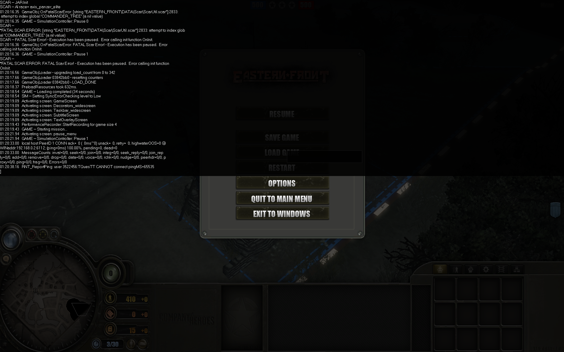

#130237
Re: 'Controlling' the AI
Hi guys, just got back from a week on the road.
@viruz777: Welcome to the club. You are quite a HasenJaeger. Please post your wishlist for EF_mod AI behaviour on the Compstompers corner THread. It will be taken under advisement. - PM me.
I too wish to see a mode of player for compstompers which allows the selection of particular AI Personalities pre-game. THis is do-able. It is not at this time politically viable in the EF_mod. I hope to change this but as Sharks suggested: We are not fast. I will add to that we are not slow, we are half fast.  :P I have hopes that perhaps by the time the first or second Ostheer patch is offered we might be able to get this feature. If you can;  Lobby JoJo. He is after all the only Dev here.
Regarding your request to fight only Jagdpanzers in TD mode this is do-able as well. Jojo has a program to select a particular reward unit and THe CT tree used in a game can be selected at start with rudumentary knowledge of lua coding. Download a copy of "notepad ++" text editor and we can get you started. I can show you how to increase the occurance of Jagdpanzers in ai play but that is not so rudimenatary. Don't let the balancers intimidate you. They are good guys but they don't understand why anyone like you and I prefer compstomping.

Hi Jojo not a problem at all. I'm sorry if I sounded impatient because I actually wasn't. I only took your word seriously that you said you'll maybe help me in a day or two when you're free  :-X Didn't mean to rush you or anything so again I apologise. I'm actually a very patient person when it comes to EF_mod releases. There's just so much to experiment and explore! (vs AI of course  :P)
To be honest I am very new to modding and have little to no experience. The last time I modded COH to my taste was back during vanilla release and I think it was Corsix's mod studio. Do I need to download that and edit the lines like you suggested? I'm still trying to understand your instructions since I'm very confused and the lines can't help but make me feel abit intimidated since I'm abit at a loss on where exactly to start..
Thanks for taking the time to help me out with this though, I really appreciate it!

I have edited the code and tried playing a game but the game pauses after finish loading and says "FATAL AI ERROR - EXECUTION PAUSED". What did I do wrong and what should I do now? All I did was add the -- to every line as shown in your example except US Armor, UK Royal Engineers, Axis Blitz, PE Tank Destroyer and Soviet Breakthrough. I started a game with US vs PE and Axis and that error message popped up.
Edit : Tried continuing my SP campaign while waiting for response and found that the editing also affected it. After loading it would stay in black screen and not continue to play cutscene. Tried replacing the edited file with the original and everything went back to normal. I'm surprised that editing this AI personality would also affect SP experience since I thought it would only affect skirmish.

Hm, am not sure what you did wrong i did not tested this yet but i will test it and will attach whole file that works.
Also it is great that you made backup of original file.

Here is part of code that should force PE to use Tank_Destroyer, And Wehr to use Blitz, i did not had much time to test it, so if it does not work inform me so i can speed up testing:
-- AXIS
elseif(race == TRACE_AXIS) then
--rewardTable = AXIS_REWARD_UNITS -- commented cuz STUG IV
UI_ForceCommanderTreeChoice(player, COMMANDER_TREE.AXIS.BLITZKRIEG) -- this is added
Hi jojo I copy pasted the edited jar.scar into /scar folder as you instructed. I also copied the entire text and pasted at the bottom of scarutil.scar and also added import "jar.scar" inside there. (if that is what you mean by import it in scarUtil.scar)
It still gave Fatal Scar Error - Execution paused.
here is screenshot :
I think it has something to do with the added lines of the command tree? Please help what should I do now?
#130575
viruz777 wrote:
Jojo do I just copy paste the whole modified jar.scar into ..\Eastern_Front\Data\scar or do I copy the entire text and paste at bottom of scarUtil.scar?
Hm, am not sure what entire text, i said edit jar.scar and all bolded is what needs to be added or commented.
Only thing you need to do with scarUtil is to add import of jar.scar after all other imports at begging of the file :).
If you get same error then i will make you new jar.scar and new scarUtil.scar and upload it here, when i will have more free time.
#130582
Ok jojo I see what you mean. Just copy edited jar.scar and paste into /scar folder, then add "import jar scar" line after garrisonbuilding.scar.
I did it already and got the same error. Did you see the screenshot of the error in console? Do you know what is causing that error or if it's something that I'm doing wrong?
Anyway yes I'd appreciate you send me the new jar.scar and new scarUtil.scar when you can :) unless it is something easily fixable on my end. Just let me know what to do next.
#130684
Here are files. PE will always use reward units, and always Tank Destroyer Doctrine. Wehr will never use reward units and always Blitzkrieg Doctrine.
Hope it helps.

#130711
It works i have tested it ;).
No problem, if you need anything else you know where to find me.
