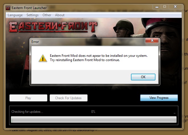

Hello,
After thoroughly reading the FAQ and tech issues I failed to find a solution to the trouble I am having right now:
I am using the steam version of COH, (OF and TOV, all Steam).
Therefore I choose the Steam path for my installation however once the Launcher is run for the first time after setup I get the error shown on err1.jpg.

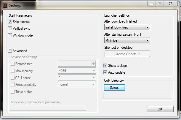

When I go to options to indicate my CoH folder I see cohdir1.jpg.

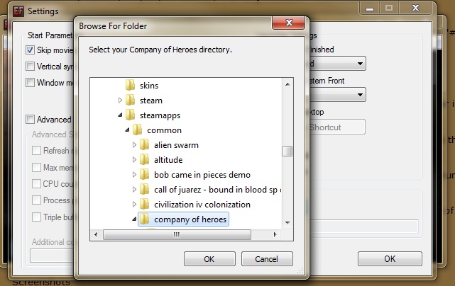

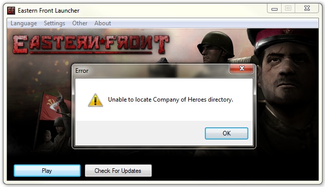

I have also uploaded EF_launcher.log file as well. The message 'Unable to locate Eastern Front Mod registry entries.' may mean something maybe?? :(
I have run my CoH,OF and ToV purchased from steam as suggested, tried running the Launcher with admin rights, and even tried the registry trick (InstallLocation, I can send a screen of it to if u like) suggested by Ritz. None has worked.  :'(
So please help me out. I have an x64, win7 system. My CoH version is 2.602 since the day it was released.
