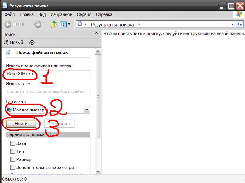

#59426
Re: How to create an Eastern Front shorcut
jumanji wrote:
ok.. :P then how do i find the correct path?
1) Using keyboard, press "windows" key (the one, that has got windows emblem on it) and then, while still pressing that "windows" key, press "f" key. Search window must appear.
2) Use the picture, provided below. That will also require you to use your keyboard, and, probably, a mouse as well.
3) The location of the file should be that very correct location you need
Best wishes!

#59430
Best wishes!
lol ;D!! Bingo :).

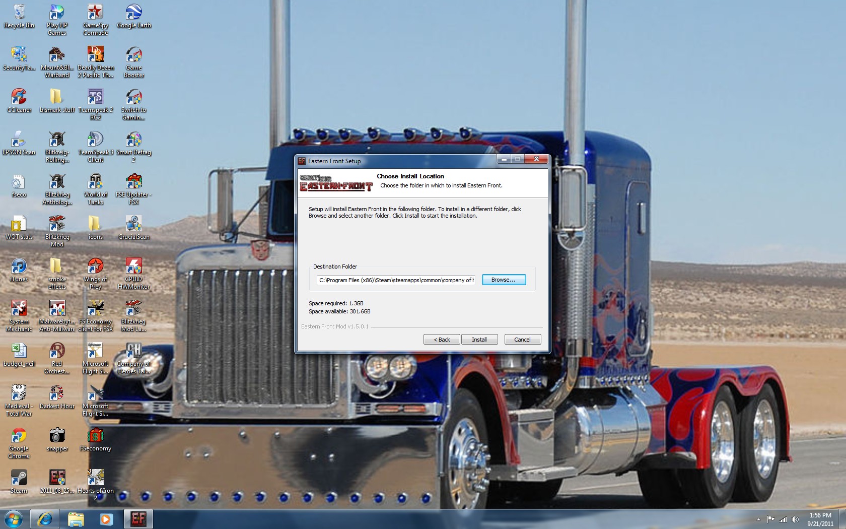

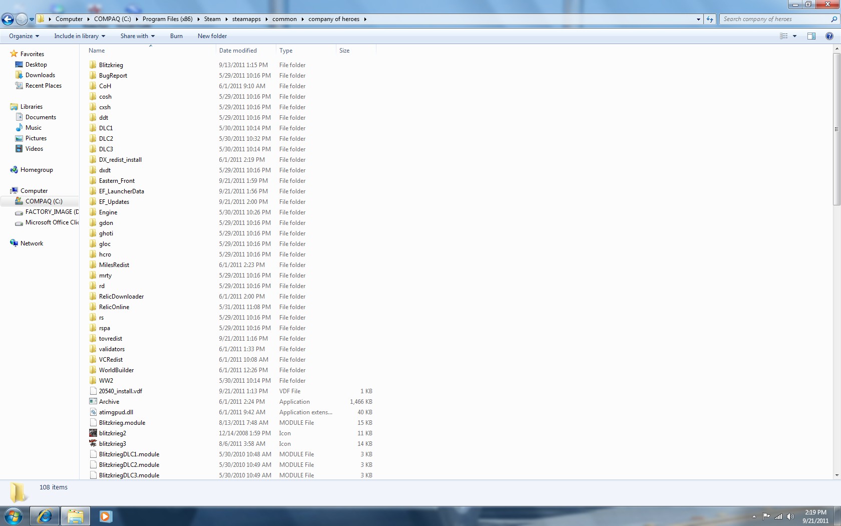

Could you post an screenshot of the folder where you installed EF? Make sure all the files and folders fit.
If you have both CoH versions, the launcher is not going to work correctly because you are supposed to have only one of them.
You will need to create a shorcut in order to make it work, or check your registry entry of CoH to see where the installlocation value points. But I would like to see your CoH directory before that :).
#91138
Ill try, here goes.
#91140
with
blackbishop wrote:But I would like to see your CoH directory before that :).
I was refereing to what i wrote first:
and what I mean with that was if you could take an screenshot from the directory itself, not the written path XD.
#91143
I think this is what you are talking about, I hope.
