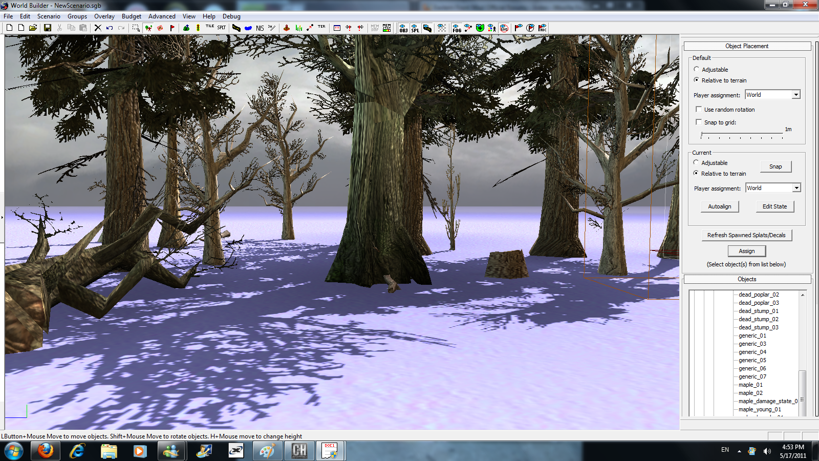

Re: Winter in USSR
With the Atmosphere Settings you already stated, I'd also add the usage of sand textures to imitate snow (sand_rough, sand_base, sand_base_hires).
For winter-like looking trees try the dead versions of the trees (oak_dead, ...).

#69666
Re: Winter in USSR
Like this?
