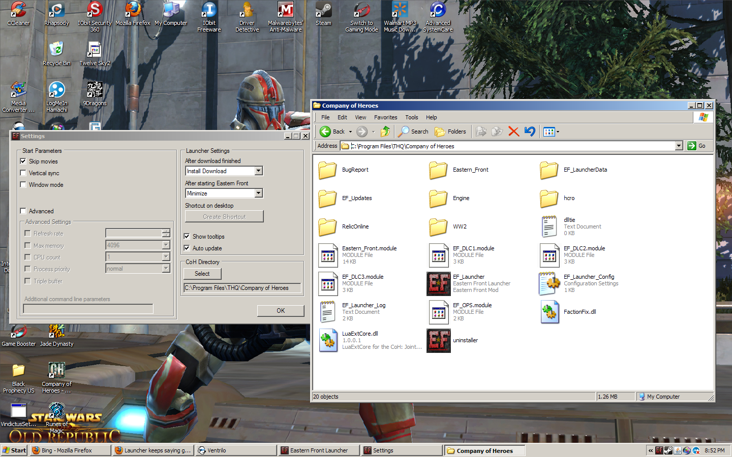

#64820
Re: Launcher keeps saying game is up to date when Hitting play
Could you post a screenshot of your coh directory?
Could you check if your launcher has the correct path associated?
Run EF Launcher ->Go to Settings -> Check CoH Directory value.
I cant figure out how to put a screenshot in this post but the game is installed on c:\\program files\thq\company of heroes.
and when i hit the settings button its the same as above.

#65262
here is a screenshot.
#65269
I'll quote myself about it.
If you install EF in a path different than Company of Heroes directory, or if you don't have installed it and you're only trying to run EF, you will get an error.
Perhaps i wasn't clear enough, but i was talking about CoH. If you don't have installed CoH and try to run EF you will get an error because EF uses CoH files.
You need to install CoH in order to play EF.
