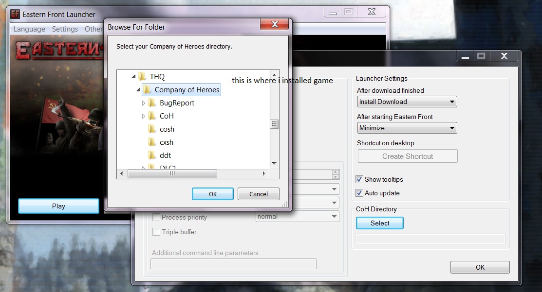

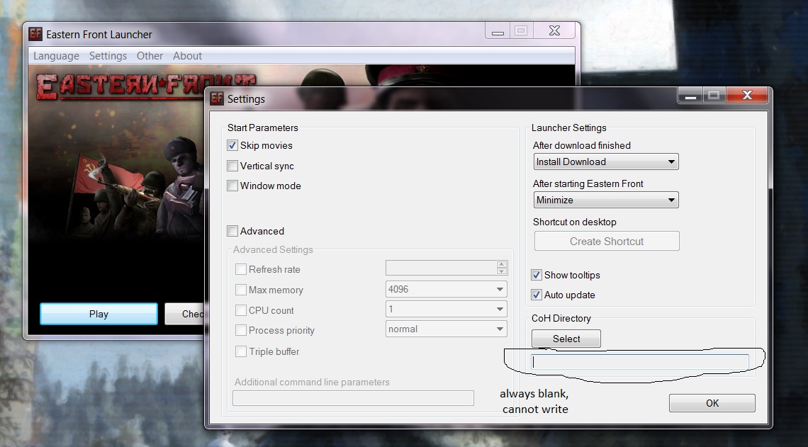

unable to locate COH directory
hi i read all posts tried everything and yet my Launcher says that there's no EF installed on my system and in settings i can't change my directory it's blank and whenever i change and apply it again it undo it then turns back to blank can you guys help me?

if you mean Launcher/Settings/CoH Directory    Even if i show it immediately turns blank.

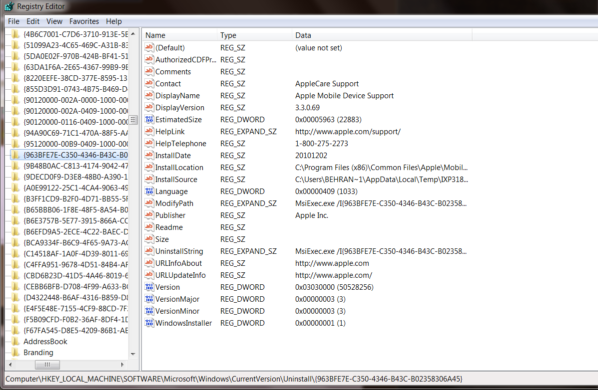

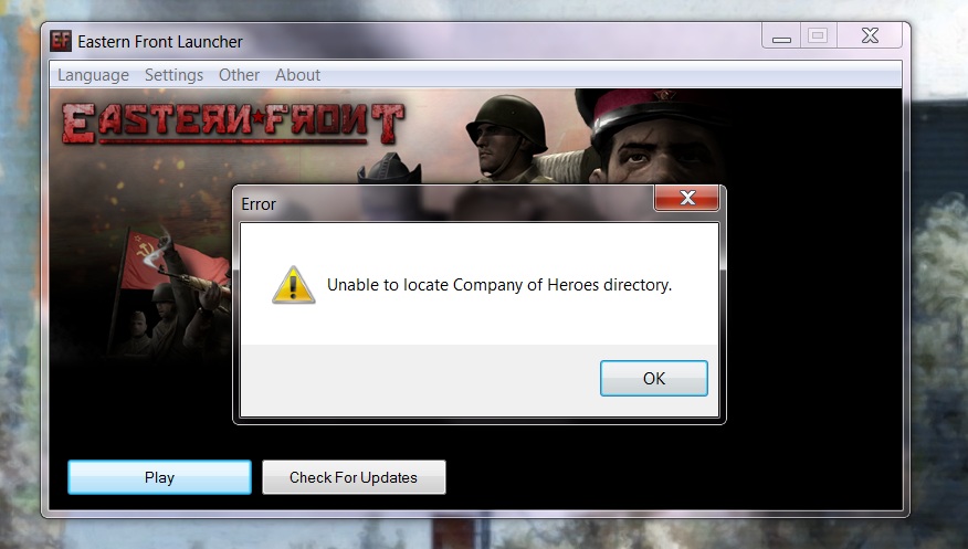

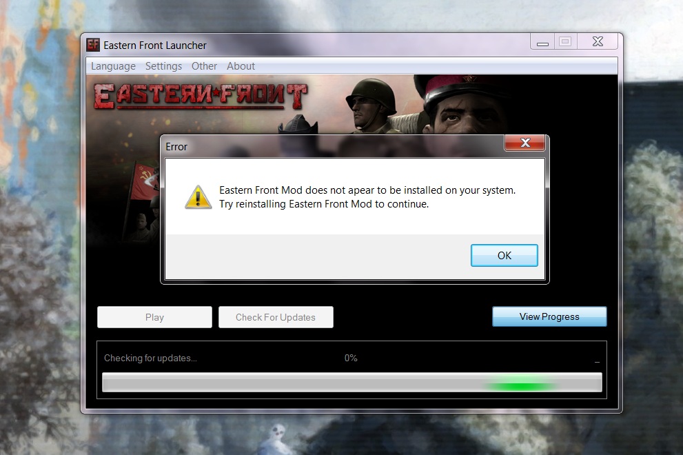

I have same problem I am using dvd version of the game and i have all patches, 1.30 of ef, i have just Coh, i've opposingfronts too but it isnt installed.when i click to play it says "cannot find file location" when i press for check for updates it says "coh doesnt apear on your system" i have tried to change coh directory in the ef settings bu  Even if i change immediately turns blank. i also searched for your advice which is
QuoteIf what @IJoe suggested didn't fix it, open regedit(start menu->run->regedit) and search for this path:
If you have 32 bits OS:
HKEY_LOCAL_MACHINE\SOFTWARE\Microsoft\Windows\CurrentVersion\Uninstall\Company of Heroes
If you have 64 bits OS:
HKEY_LOCAL_MACHINE\SOFTWARE\Wow6432Node\Microsoft\Windows\CurrentVersion\Uninstall\Company of Heroes
and check if the path there is the correct location of your CoH Directory.
    WHat is this? i find that location's folders and i dont understand what i should do? my coh directory is true also.
#55994
Re: unable to locate COH directory
@Panzer
That registry key has a String value called "InstallLocation", it's value must be your current company of heroes directory. If has anything else or doesn't exists EF launcher will give an error.

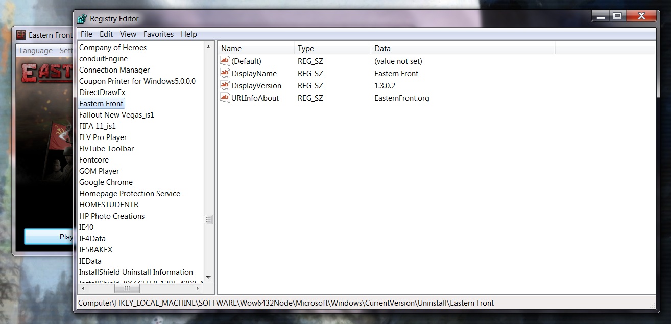

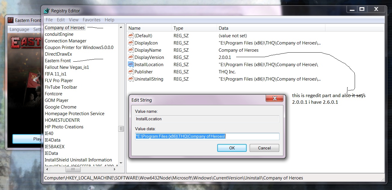

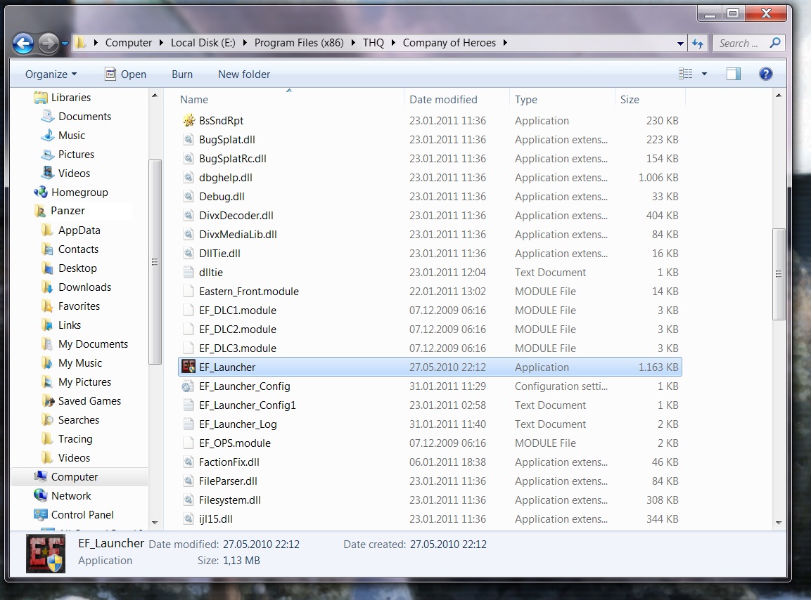

thanks for tryin to help me im really glad, but it doesnt work again, same issue, now i've installed 131 anda 132 coh opposing also, i took some ss to help you
Looks like you are missing an end quotation mark on InstallLocation string.
Or... you are not supposed to have a start quotation mark on the same one. Try adding in the end, then removing both.
#56915
@Rizz
:o!! How could I overlooked that!!
@Panzer
Rizz is right, you need to remove the quotation mark from it... that value doesn't need it.

E:\Program Files (x86)\THQ\Company of Heroes this is the directory
and i use 64bits
i removed the marks but FAIL again :D i tried everything! and everyday i want to play it more :D but something is blocking me, if you can help me please keep trying, thank you :D
#56927
:-\... remove the last back-slash from the InstallLocation value and try again ???.
Could you post also the values of this path?
HKEY_LOCAL_MACHINE\SOFTWARE\Wow6432Node\Microsoft\Windows\CurrentVersion\Uninstall\{97AFD0D8-5720-4A59-BFDC-CB92A36FADF9}_is1
can you export it, zip' it and upload it here?
