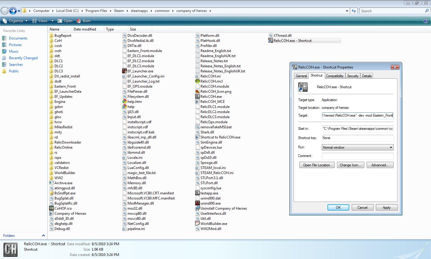

I've purchased my copy of CoH from Steam, it looks like this when I open the properties,
My copy isn't on a USB drive either, but I still get the same error message.

Re: USB Eastern Front mod can't find COH directory
You're showing me the Properties of the .exe file itself... Right click on it, select "Create Shortcut" - a file "reliccoh - shortcut" will appear. The open it's properties and do what Rizz suggested above.

#43013
Like this? Sorry for the delay, computer dumped on me and took 4 days to fix. Anyways, i did so and it gave me the same error message. i found something though...
I have C:\Program Files\Steam\steamapps\common\company of heroes
AND C:\Users\User\Documents\My Games\Company of Heroes
also i though i had a THQ folder somewhere else but i cant seem to find it...
