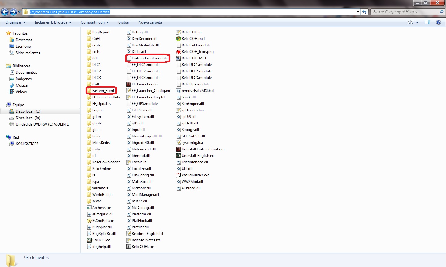

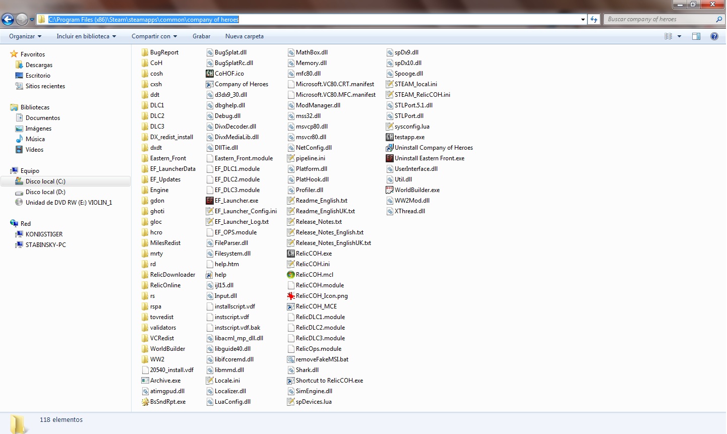

Your comments made me uninstall my dvd version and reinstall my steam backup... It works as fine as the retail version, i have Windows 7 "x64" and works perfectly.
Please check again in Settings that "CoH Directory" be:
a)By Default on x86
C:\Program Files\THQ\Company of Heroes - DVD version
C:\Program Files\Steam\steamapps\common\company of heroes - Steam version
b)By Default on x86 64
C:\Program Files (x86)\THQ\Company of Heroes - DVD version
C:\Program Files (x86)\Steam\steamapps\common\company of heroes - Steam version
c)In another directory of your choice
Remember that when installing EF will be asked to choice your path, and gives you by default one. If you change it, remember to change it on the launcher because it doesn't save any other path than default. I attach a couple of pictures of my files.

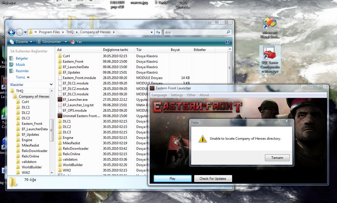

Re: unable to locate COH directory
i do have the same problem, i have dvd version of coh, eastern front launcher cannot find coh directory, and also in settings, under change directory tab there is no directory, im sure i installed it to where it should be under (c prog files thq coh), need help!
thanks in advance
#36908
If there's no path on Settings, you should click on Select->Browse until you find the path and select it; it shouldn't take a lot of time you already know it.
#37000
no mister black bishop, you got me wrong, ive already did that, everytime i choose the right path and clicked ok in settings the same thing happens unable to locate coh directory and when i return back to settings tab, locate directory tab is empty again!

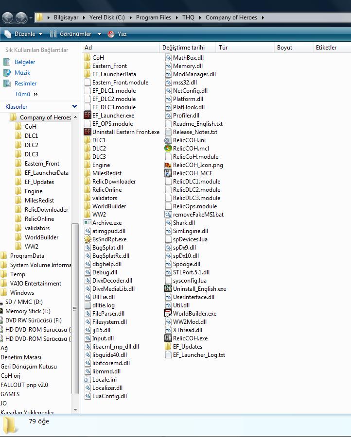

Do you really have installed CoH? Could you upload a screenshot of your CoH path?
#37191
of course i can! here it is
#37207
Do you have retail or steam version? Do you partially uninstalled CoH?
could you upload the same screenshot but in list view instead of details?
By the way where you install CoH it'll be installed EF you don't need to move anything. The installer does all the work in both cases(except if you choose another location for CoH you need to select it when installing and before playing the first time).
