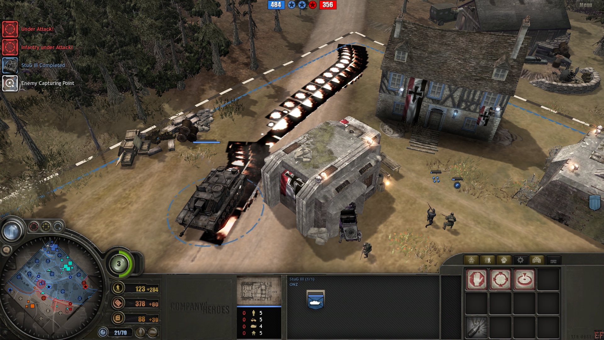

After loading a saved game where i had a bunch of vet 4 brandenburgers with LMGs, they were equipped with their default mosin rifles instead of the lmgs they picked up. However, after a guy died and another reinforced the LMG was back
My personal favorite

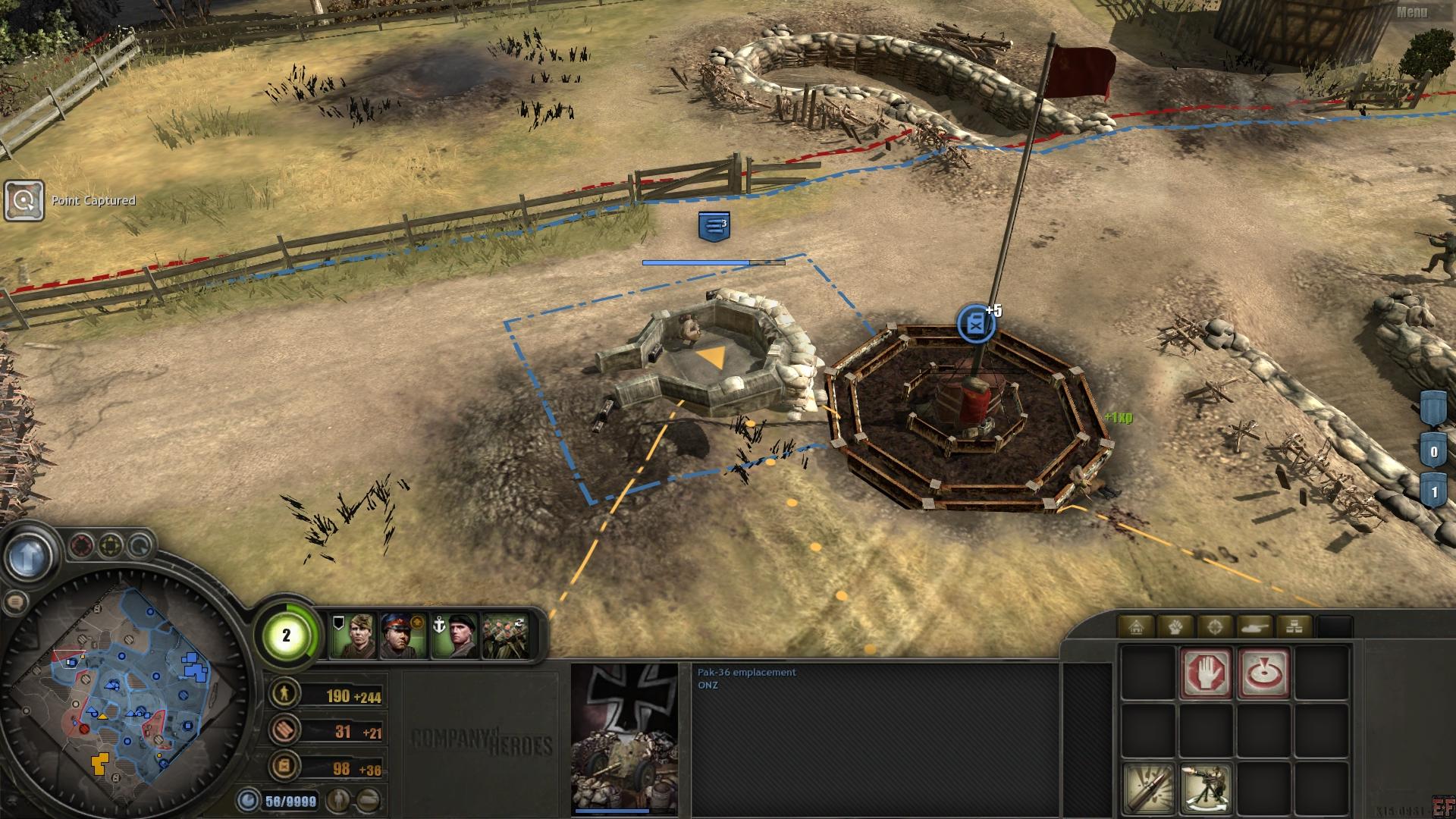

Another bug;
I try to place a Soviet Tank Hall
I click where I want it to go
the bluehighlight showing where it'll be stays there
My ingenery move to make it
then it disappears and nothing happens.
It took me over 35 minutes to get a tank hall when I was floating in fuel

Re: 2.300 Bugs
Correct me if I am wrong( Bish?), but the angle of fire has been adjusted internally.
I am not sure what you mean with the second bug. Did you click your engies to move by accident or something of the sort? Technically, it should just be click and they start to build.
#155564
Re: 2.300 Bugs
Yeah, nothing more can be done until the new model comes up.
About the second "bug", that happens when something changes in the terrain or the resources, perhaps one unit ran in the area, perhaps an invisible unit was there or the resources were not enough by the time it arrived to start to build. There is nothing wrong with the building other than it is not the proper Tank Hall building.

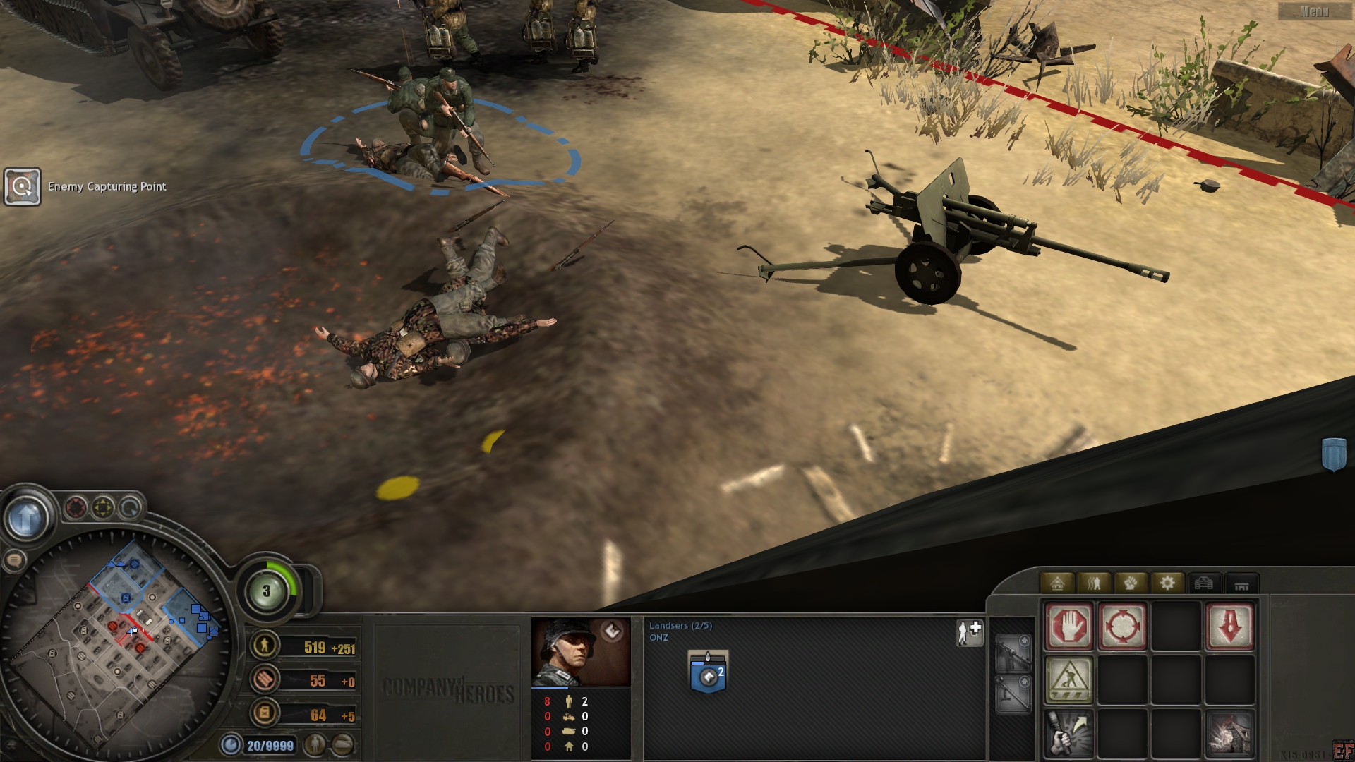

I wonder if this issue has been reported. Just for some heads on (2.602, not sure if it happens in 2.7).
Most weapon recrew have bugs. So far I have noticed:
- OH infantry attempt to recrew Soviet's AT will auto killed (after a brief red icon on the AT unit).
- PE cannot recrew Soviet MGs, and even if they do, if the unit is down to 1 men, you cannot do anything nor select the unit. (need to kill with grenade)
- Some infantry (Soviet, Wehr) can recrew the weapon but cannot reinforce crews. (Happened in AT and MG)
#155772
Re: 2.300 Bugs
Yeah, that bug was already reported and was fixed.

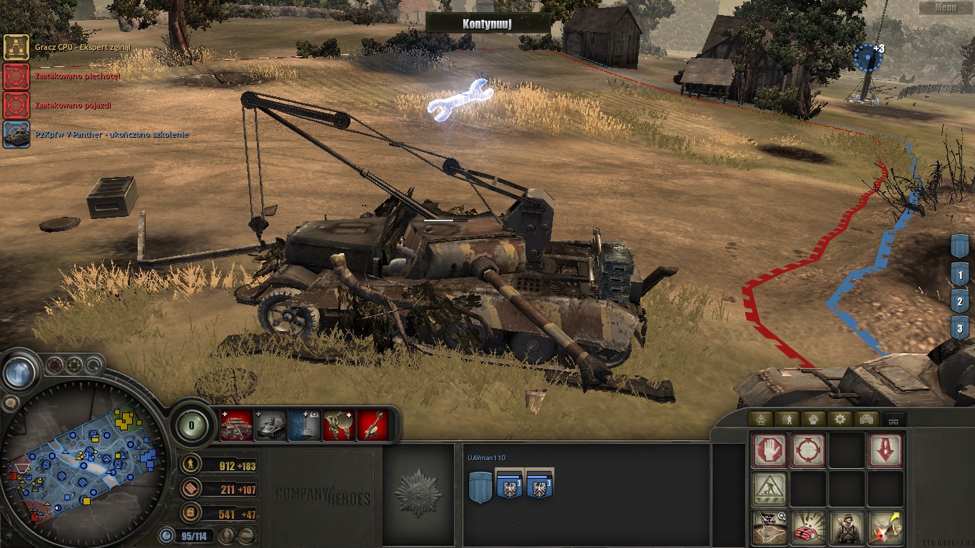

If Famo uses its Retrieve Beutepanzer ability, and the camera move somewhere else so it's not visible, when looking back it will be inside the wreckage and the process will be halted (there is health bar above wreckage, but it doesn't move at all).
Ost AI builds multiple Famo at some point of the battle.

1.only soviet infantry can capture zis AT gun
2.Pak 36 emplacement when be captured don't work
3.attack move order don't have sound for any unite
4.splash for Stug III, it only sometime happen

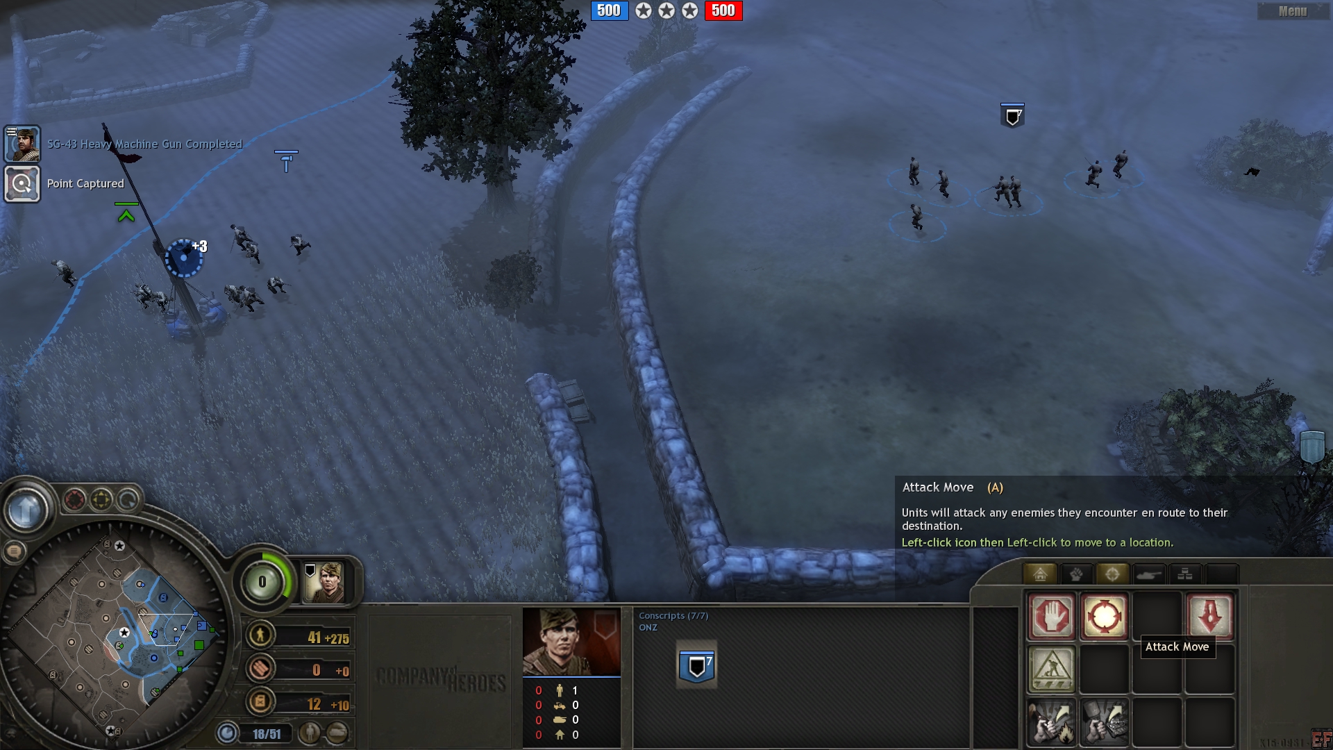

When I order an MG squad to go on combat patrol, the A key on the keyboard, the team will head off, an sometimes this will happen:
The team will encounter enemy infantry, deploy MG and engage. Enemy retreat, the loader and the helper will move on to the designated location, but the gunner will halt on his positio. The team can end up being separated by a very large distance, resulting in some weird situations if the gunner, or the other two, gets killed.
I have also seen other strange things where the MG team will deploy the MG facing the wrong direction, pack it back up, redeploy, pack up again, and redeploy yet again - and by this time they are pretty much history or hauling ass back to base.
That can't be fixed, these are the regular animations for HMGs.

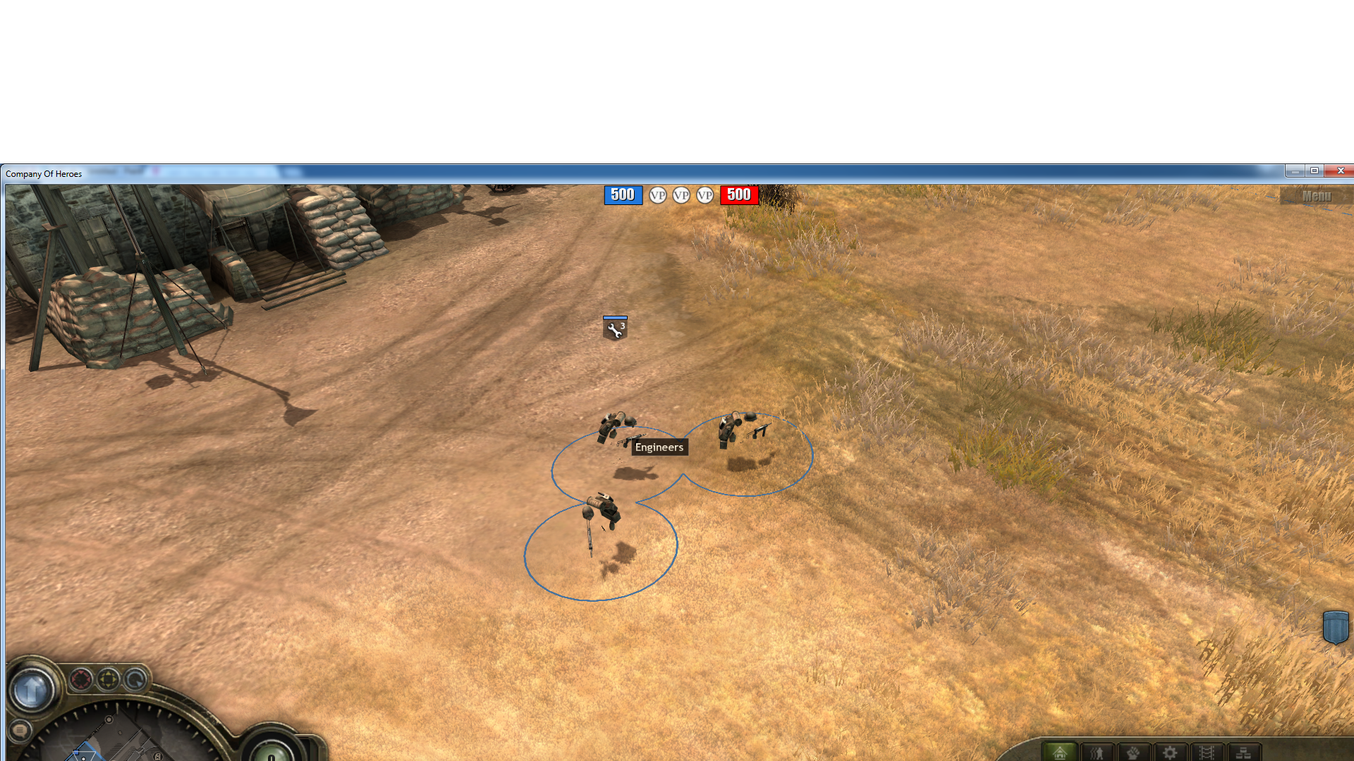

I've played this mod and it awesome but i had some strange bugs:
  US engineer don't have the body or head, just helmet and gun.
  Sometime there's no sound when i play a match.
Maybe it because i'm not using the steam version of this game.

The T-90 doesn't appear to take any damage from the OH Goliath. Will continue to playtest to make sure.
The OH description of emplacements healing infantry in the same sector is false; I've seen no evidence of healing.
The text for the medic emplacement needs to be updated; it makes no mention of having to be in the HQ sector to heal; it doesn't even mention the ability to heal at all :P.
