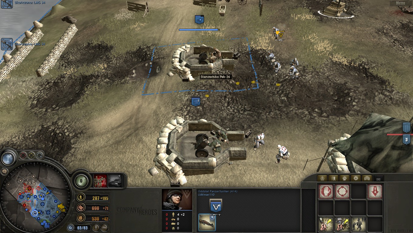

Pak emplacement for the fotress doctrine looks like it is manned by soviet weapon crew.
My personal favorite
#154867
Re: 2.300 Bugs
The emplacement above is the original one, you can clearly see Soviet crew as stated above. The one below is recrewed and it has MG emblem
#154868
Re: 2.300 Bugs
That has already been reported and fixed :), but thanks for the heads up.

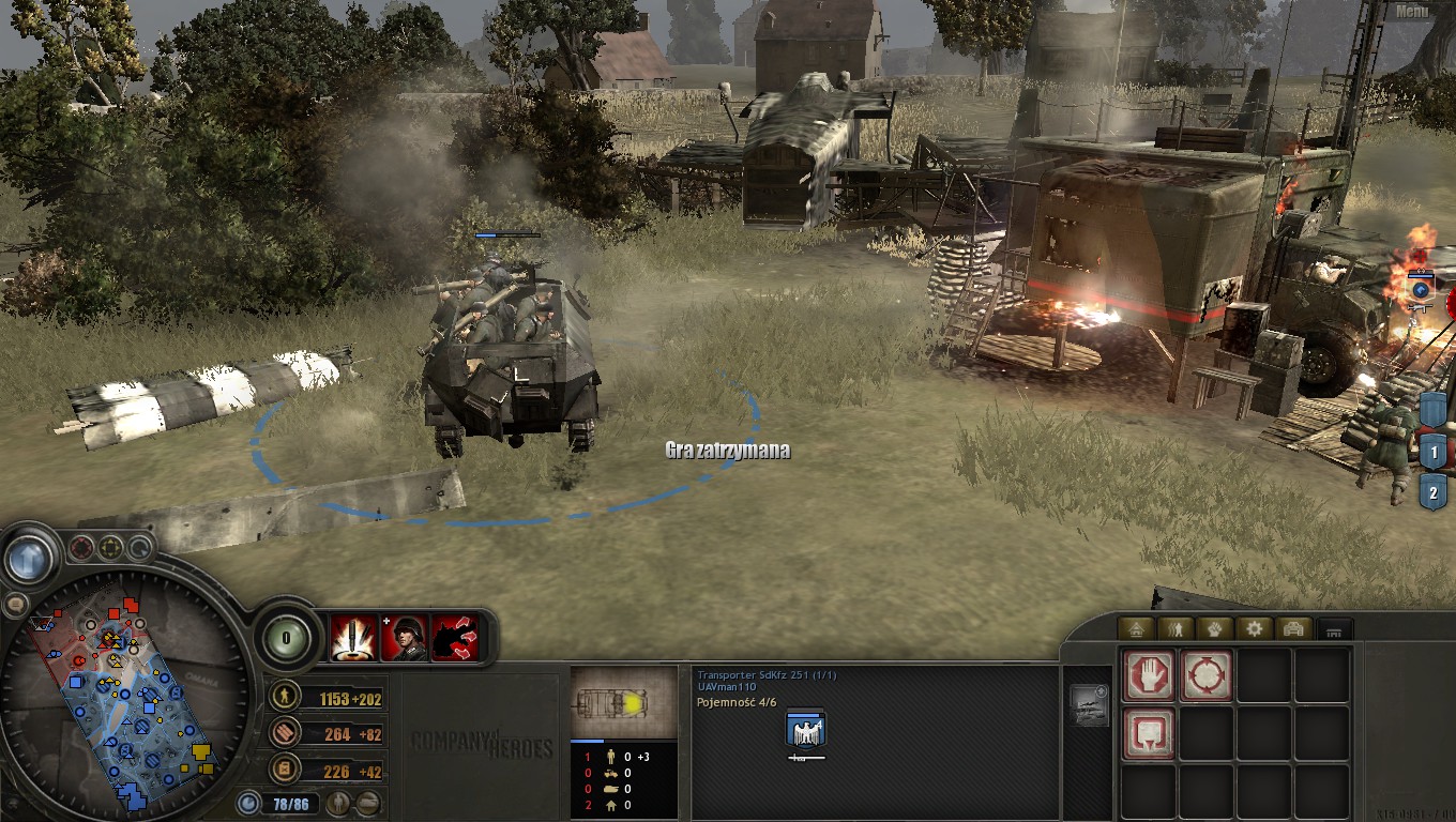

Units in Ostheer halftrack are facing wrong direction when attacking enemy (they are shooting with their backs).

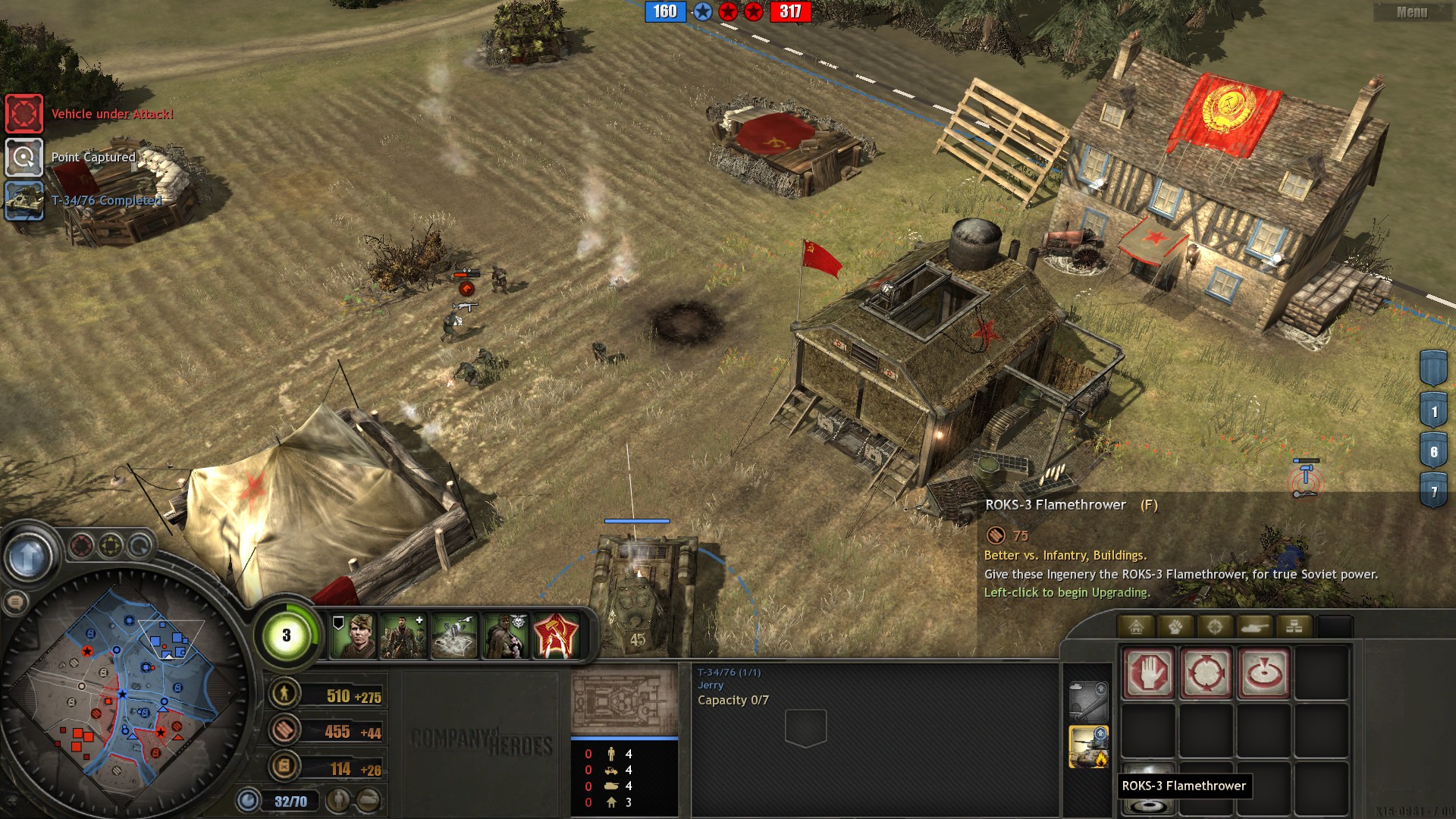

-When upgrading T34/76 with flamethrower and later with 85mm cannon, there is no flame animation, instead it will fire from its hull MG, however fire damage is still applied.

So there's an ingenery with a flamethrower inside the tank? ;)
http://cloud-4.steampowered.com/ugc/38603820159599908/39FBC687D95A2C17C0357931C4AB61F2A7FE768E/
