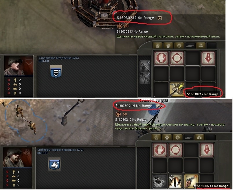

Re: [[IP address redacted]] Bugs and issues.
some text mistakes in the Russian version
