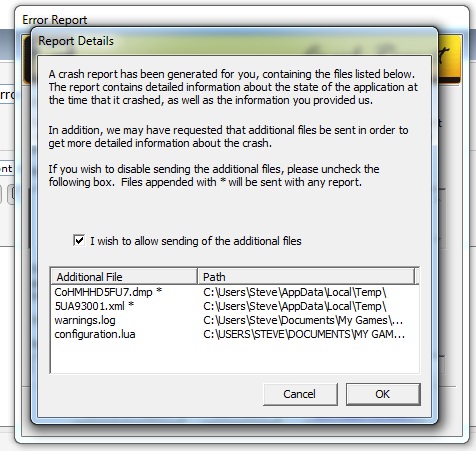

What logs do you guys need? I just patched to the latest patch using the launcher. All I did was click Play. It hangs for about 5 or so seconds, then gives the error report that I attached. Nothing actually launched either. It just sits at my desktop.

This means you have missing files in your EF installation, have you used the lattest full installer vefore the auto-patching? Maybe the patch wasn't installed correctly, you can try running with admin rights the patches once more, you will find them on your EF_Updates folder inside your CoH directory.
Good work posting the logs btw.

So uninstall it, and use the newest installer? I don't think my installer is the latest version. I'll try that.
-e-
This solved it.
