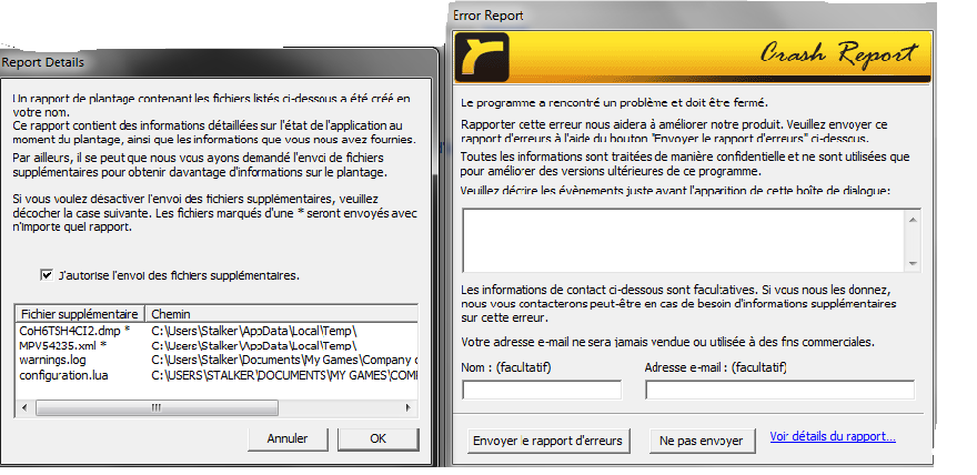

Hello everyone I have a problem, I run the lunching (it is in French) is a day I click play and after a few seconds a message appears relic "Crash report"
  What to do? thank you to you.

Re: Crash report
You need to upload your warnings.log.

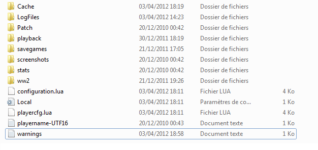

Go to My Games\Company of Heroes\ and get your warnings.log.
Go to your temp folder and look for your dmp file of the crash. You will recognize it for the time of creation. Temp folders paths are posted in one of your previous comments.
If you are not sure these files have the correct information, try to force a crash once more so you can get them right after that happens.
Once you have both files, click "Reply" in this topic and select Additional Options->attach and then upload your files one by one.

Re: Crash report
I can not find another file called  :-\
