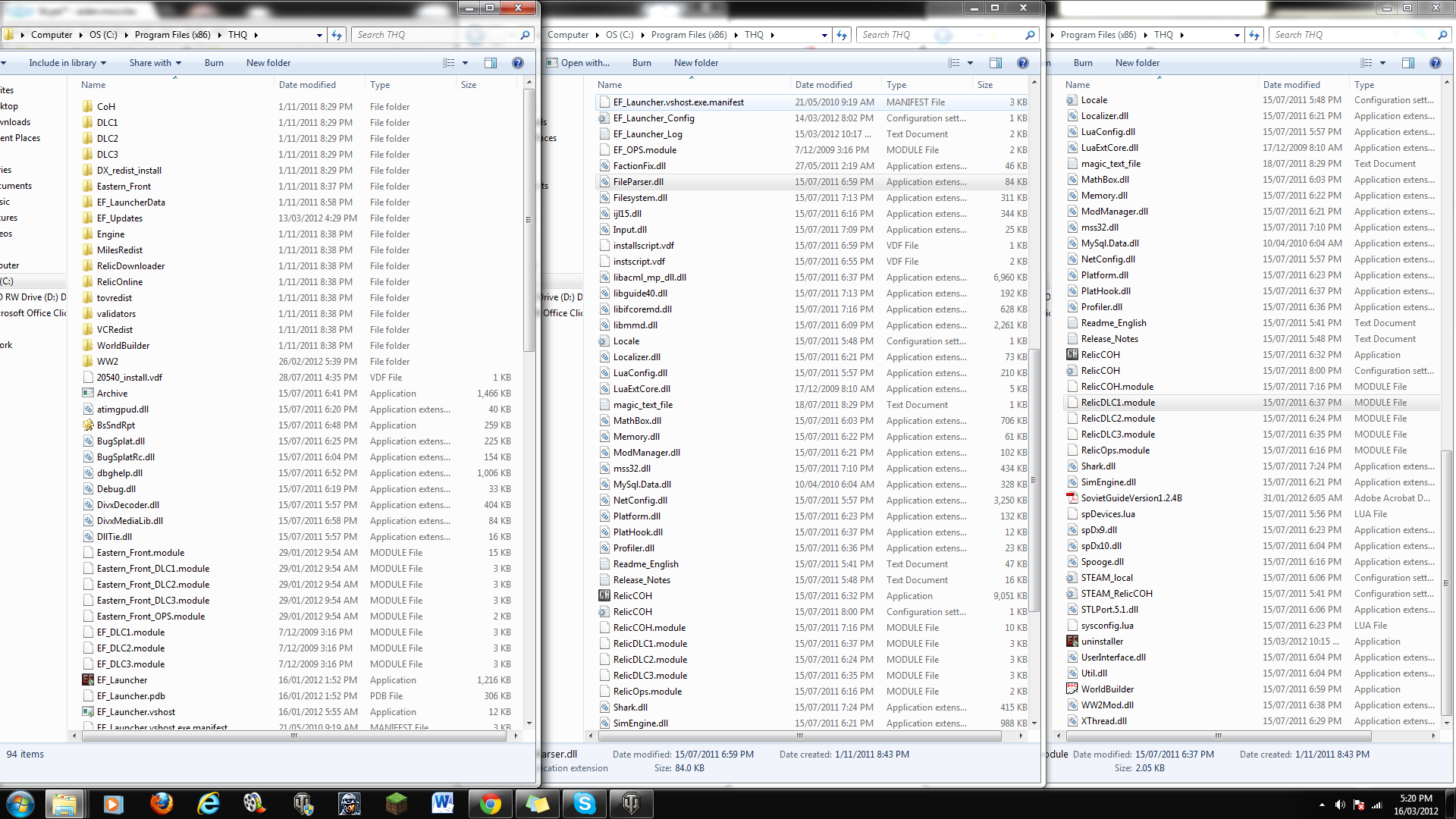

Could you post a screenshot of your CoH directory? Make sure all the files appear.
#113328
Re: Eastern Fronts not loading!
Picture here, directory is top left fyi

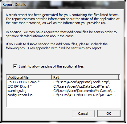

#113333
Another pic of the Error report
Check if it is installed on the correct path, maybe it installed the files inside "C:\Program Files (x86)\THQ\Company of Heroes".
Btw, why did you installed CoH on that path? I always have thought than it always shall to be installed inside "company of heroes" folder. Did you install it in that path or you moved it manually?
#113509
I just fixed it! i moved the EF files with the original CoH files in the "C:\Program Files (x86)\THQ\" directory. thank you for your help guys!
