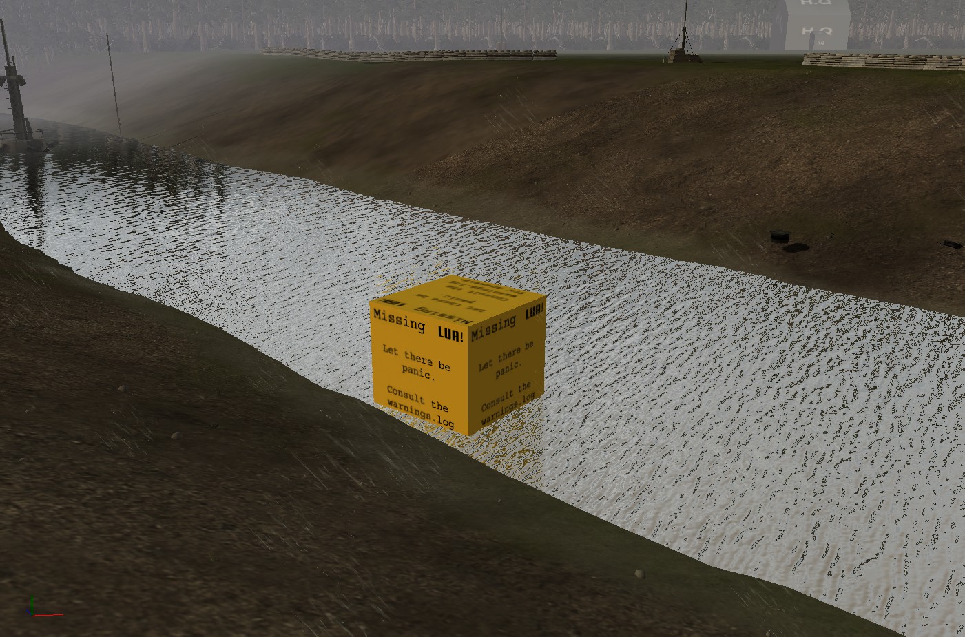

How do i remove these?
i've tried undo and reloading but it stays there and i don't want to revert back to an earlier version of the map.
#85405
Re: Lua errors
Either just select the object and delete it or if that doesn't work, open your console in WB, key should be ~ and type "wb_orphan_nuke_entity" (without "s), move your cursor onto the object and press enter. You can delete objects that are unselectable in this way.

You can also use this command, but only replacing entity with spalt to get rid of nasty splats left behind some objects.

is there a manual way to open console? when i press ~ it loaded for a second and then closed and now wont load again
#85417
Re: Lua errors
There is no manual way AFAIK.

I think it's actually Ctrl + Shift + Key right of L (which is ~ on US keyboards?).
That is for ingame COH, for WB it's just that key left of L.

On QWERTY keyboards, tilde (~) is left of 1.

cheers guys, i got confused because on my keyboard (~) is next to enter and (`) is the usual console button.

It's not "~" but the key next to "L", it could be "~" or not but still will work ;).

For German it's "ö"  ;D

I just tried but it still doesn't load anything, could it be due to me having a steam version of the game?

You may need to launch WB in -dev mode, I don't remember.
