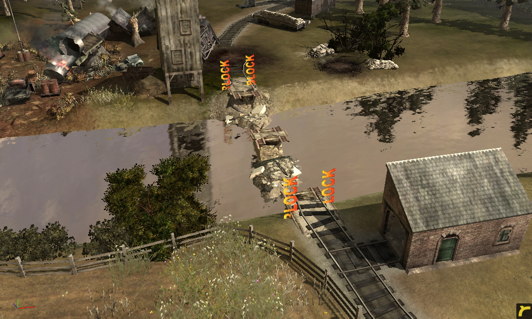

I would put a picture, but I have no time. In ebps > gameplay  use move_blocker2. Put 2 of those on each side of the infantry bridges entrances, so there is only room for infantry to cross. That's my solution, though there may be a more elegant one.

Okay, thanks! Here it is.

Ok, so you used the object of the predestroyed footbridge? Maybe that is the flaw and you should use the normal one and do this:
- Click on "Edit state" in the toolbar to the right
- Select "Add"
- Select "DCA State: bridge"
- Double-click on the text that has just appeared
- Select "wrecked" instead of "normal".
Now you have a (hopefully) working, predestroyed footbridge.
And about that engine shed: The railway tracks are not that favourable for trains which want to turn either left or right :P
Try using a branch instead of this crossroad-like compilation of railroads. :)

I tried that, but whenever I load the map the bridge is not destroyed, even though it is set as it. And for the railroad, I know. This is a map that I made when I first found out about worldbuilder, and now that I know how to do things better, I'm redoing it. I just haven't gotten there yet. Thanks though.
