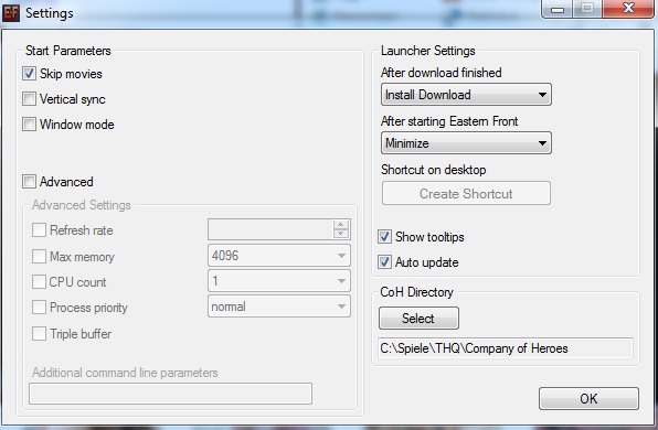

Try opening the "settings" menu (top left of the launcher window), check if the "game directory" is set/correctly set, set the correct path, if that proves to be otherwise.

ok thx. i found some threads with the same prob.
but i installed in the right directory i think.

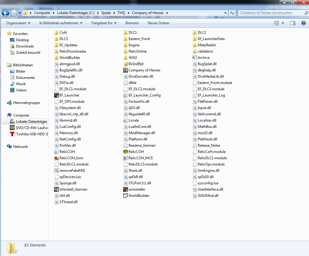

You don't have a "RelicCoH" looks like you renamed it to "Company of Heroes" instead.
Rename it again to RelicCoH.

IT WORKS
didn't know that I have ever been renamed the .exe
thx blackbishop  :) :) :)
