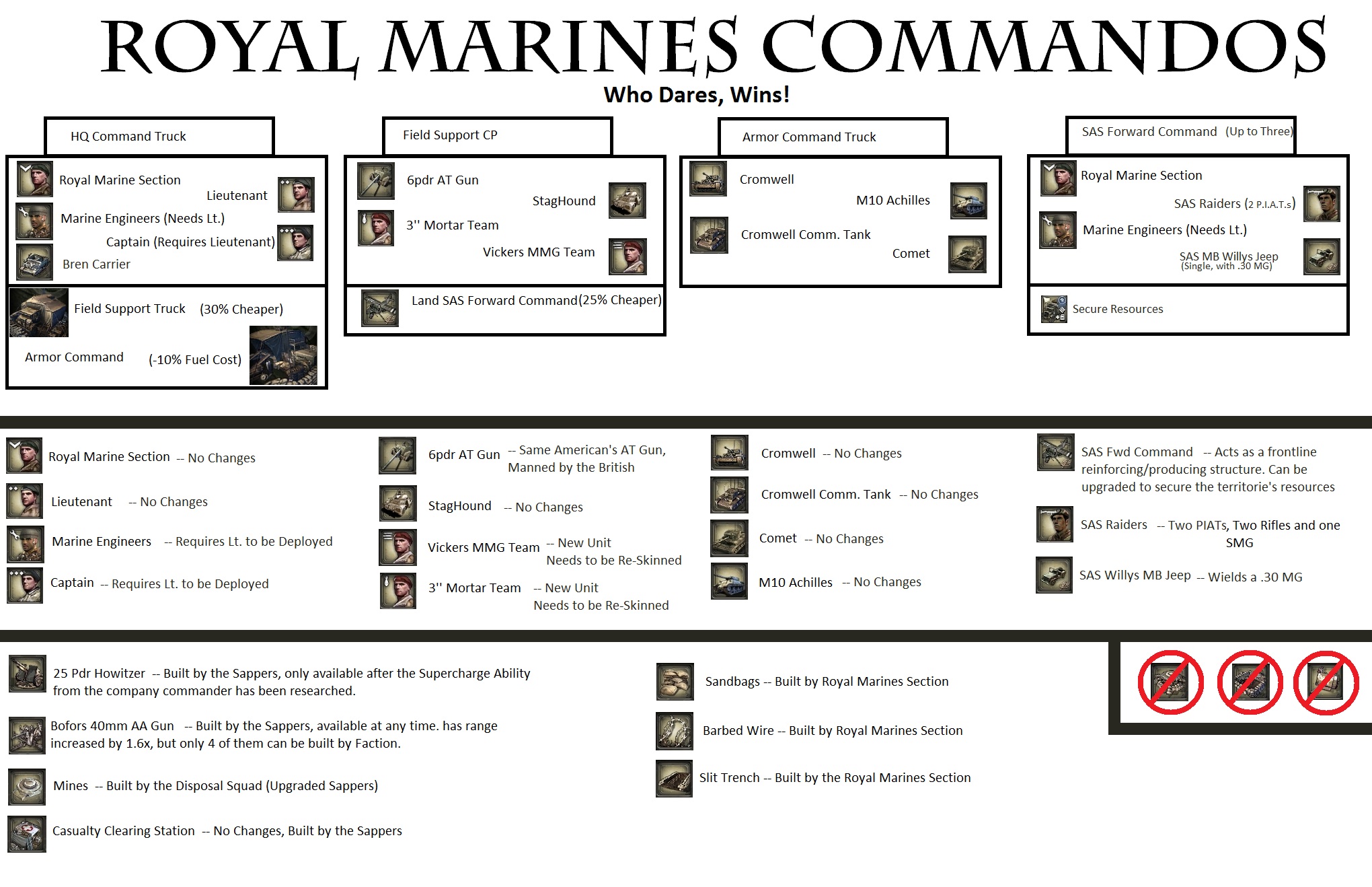

Well, i've been playing with the Commonwealth's normal faction for a long time, and, when the EF's 1.30 upgrade launched the RMC, with the title of an Assault Orientated Army, i tought, Wonderful!, but when i played with them for a few times, i didn't notice the Assault Part of the mod, probably because they still have 17pdrs, 25pdrs, bofors 40mm, all together, this makes them a very defensive faction. So, i've elaborated a few changes to the RMC faction, which i think should be at least considered as idea for further updates.

I Have Also Made a Small Unit Board:
To a Bigger-Sized Board, download the Attachment.
I Honestly don't believe that it is ever going to be considered, but at least i could show that the Assault Orientated RMC Faction, is actually like a Defensive Commonwealth with different name.
Thanks for your consideration.

So basically you want Brits to go back to being a linear faction by always going LT-CT-Heavy armour? What you get now as RMC are options.
Clearly you haven't played against them if you think they're a defensive faction just because they can build emplacements. Just because Wehr can build bunkers and flaks doesn't mean you have to play them defensively. A good player with Brits has never actually been defensive and even less so now. The emplacements are just there as support. Your idea of removing 25lbers is especially dubious since they are already the worst arty in the game and essential for the brits to break a gren/bunker spam up.
Personally, I think the only valuable thing you said was about the jeep squads not facing correctly etc. However, jeep squads are a unique addition and reasonably well balanced apart from the fact you can't see individual health and other small bugs.

I have to agree with what he said, you seem to have gotten too used to playing with the reg Brits.
The only thing I would change for the new Brits is the Doctrines, which I believe are still a tad to defensive oriented (especially the Royal Arty),but thats my own opinion.
As a matter of fact now that i re-echecked your concept, I noticed that you want to give the SAS Raiders 1 extra member and change the weapons kit to be 2 PIATs, 2 Lee-Enfields, and 1 Sten . Now i'm not the smartest guy in the world but I know without a doubt most raids take place in CQB (especially in this game).
SO why in the name of GodlikeDennis would you want to give them 2 Rifles, 2 PIATS, AND 1 BLOODY STEN. Why can't the people realize that the Thompson was used by the SAS throughout the war and i recall reading that many of them prefered the Tommygun over the Sten.
Also according to the CoH-stats website the only differences between the Tommygun and the Sten are the Tommygun's lower reload, (4.0-3.0 for the Sten compared to 3.7-2.9 for the Thompson), Tommygun's higher min. cooldown (3 for the Sten compared to 3.4 for Tommygun) and the Stens higher reload frequency (7-5 as compared to 2-2 for the Tommygun). So please just let the SAS keep their 3 Thompsons and 1 PIAT.
It accually makes them more offensive since emplacements are crap and Marines cant use slow moving 57mm. They have to use PIATs (available at T1 instead of T2) and all kinds of light vechicles.

Our RMC will remain as they are. They certainly do not need any further major changes and have proven to be surprisingly well balanced in just 2 patches.
I've yet to come across any serious balance concerns and they feel like a better faction than the vanila Brits. Although most people hate playing Brits regardless... ::)
