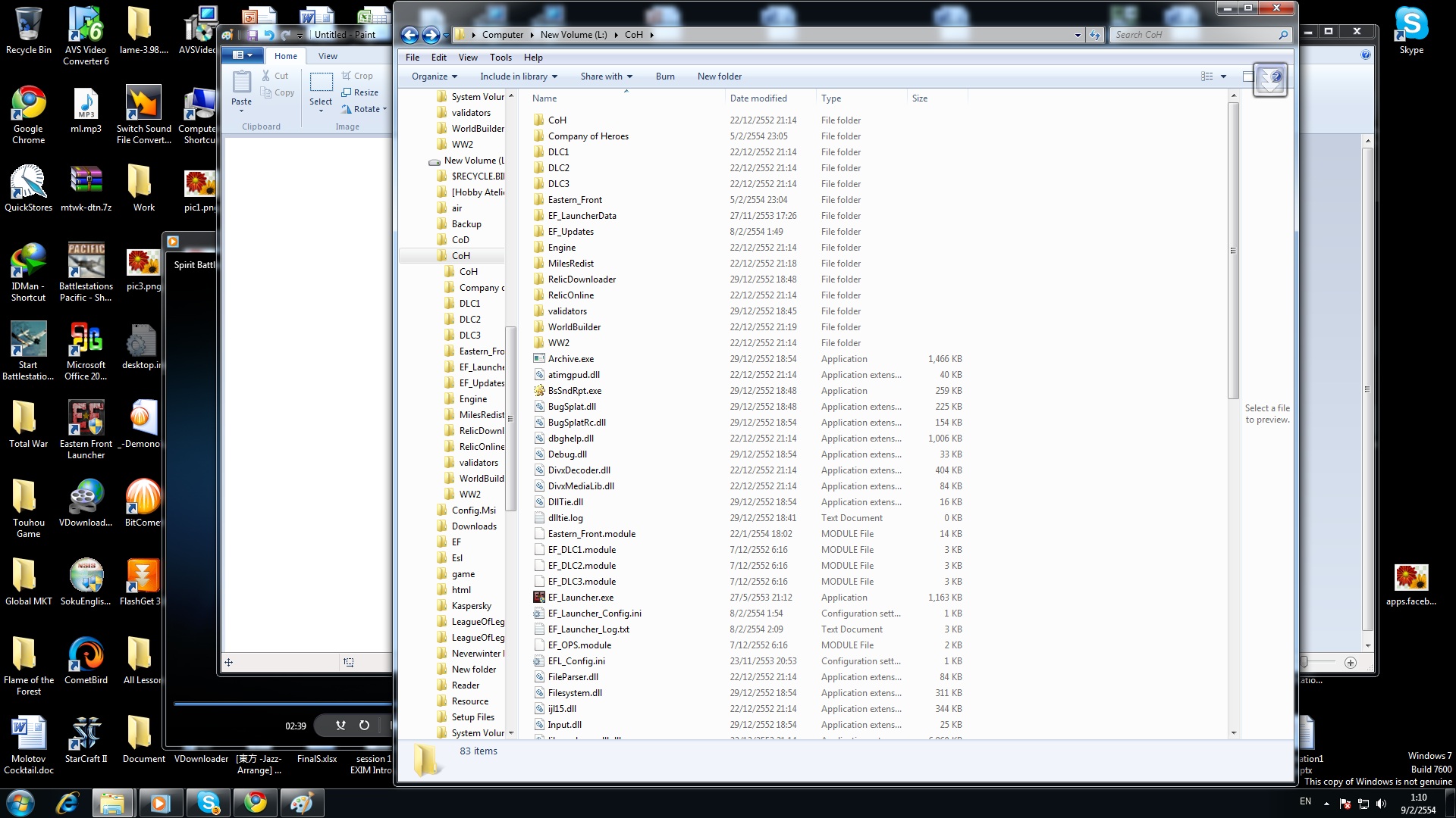

#57694
Re: Luncher stuck after update
could you post an screenshot of your CoH Directory? :-\

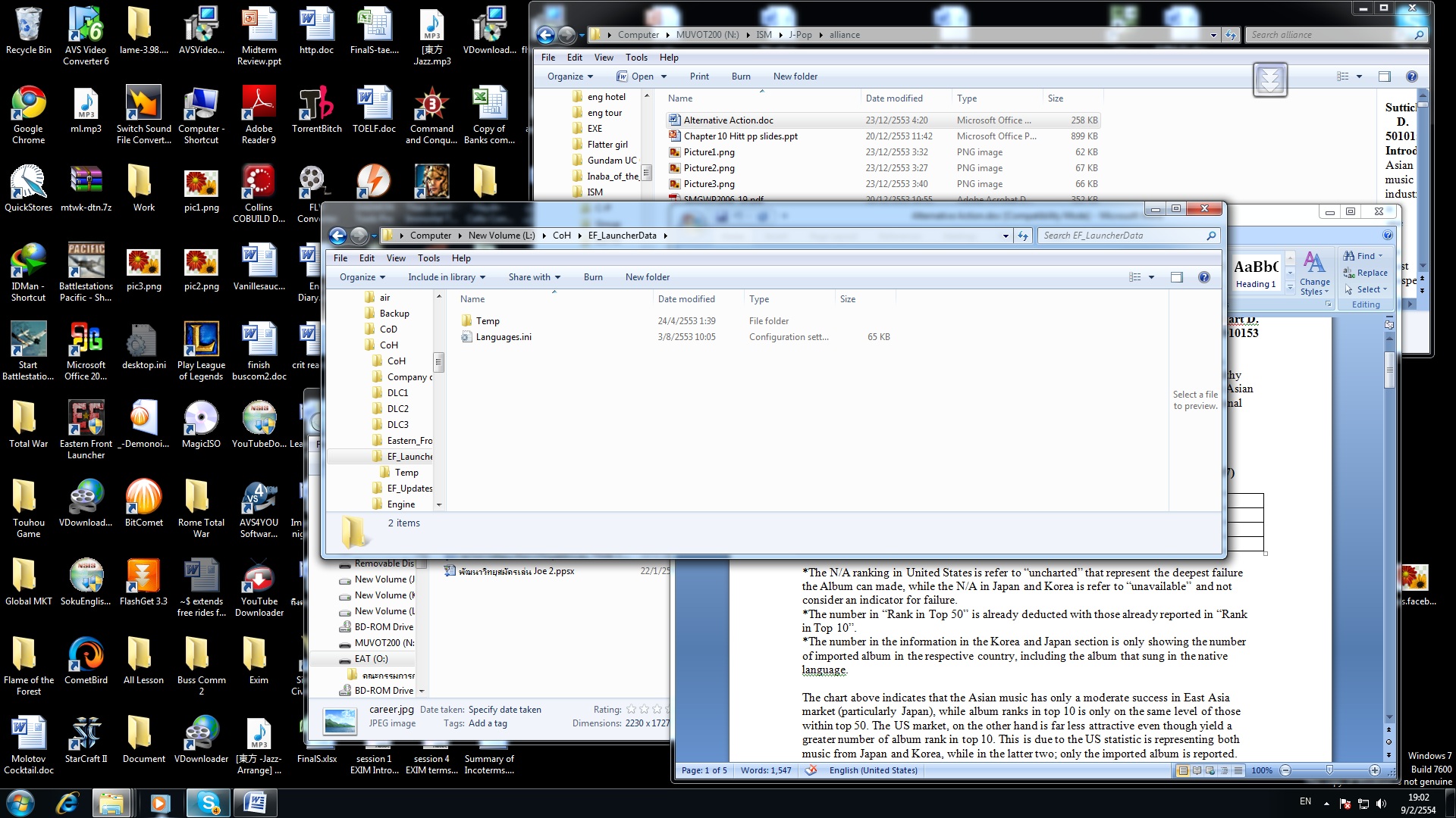

#57705
Thank you, here is the folder
hope its help
Post Merge: [time]1297181674[/time]
hope its help

#57710
Could you upload your EF_Launcher_Log.txt located on that folder?
Are you sure you are running "CoH\EF_Launcher.exe" and not running the launcher from any other location? "Company of Heroes" and "CoH" subdirectories seems suspicious...
#57779
you mean this one? the one inside the temp is empty though.
the suspicious folder is mostly the container of any downloaded patch or mod or anything related to CoH, I just kept it in the same folder
