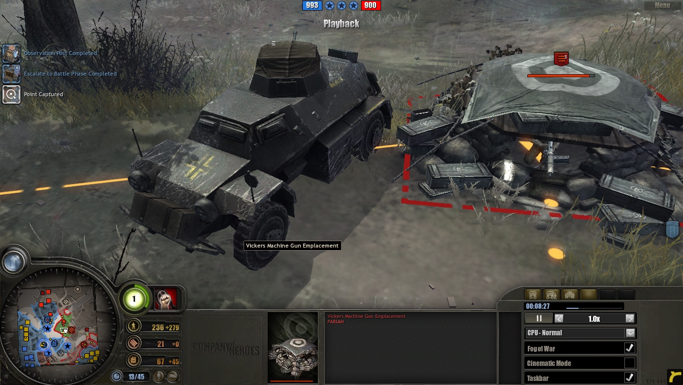

I don’t know if you changed the Vickers or not when placing it in the new British faction but it just sees to weak for what it costs. I was playing a game the other night and watched a volks squad (no vet) in cover at about mid to long range almost solo a MG nest from the front had I not sent squads to help they probably would have won.
A few buff ideas might be
Add the ability to change target- currently the Vickers deals that little suppression and damage that I have just watch a number of unveted squads walk past as one takes the bait.
Increase damage or suppression (not both)
Increase health – 100 HP should do it small arms just make light work of these things
Enable the ability to rotate – about 4 seconds should keep things fairly balanced with low suppression and long pack up and put down timer you are not going to be able to do it in emergency situation nor are you going to be able to suppress multiple squads on different sides but it will add a something a little different to the faction

The vickers is fine. You shouldn't need to worry about empacements too much anyway as RMC since your troops are mobile and can get anywhere needed quite quickly. The vickers does less damage the .30cal, less suppression than MG42, but greater range and fire arc than both.
There is simply no way that a volks squad came remotely close to beating it. Replay or it didn't happen.
To sum up again, vickers is fine.

i did test it and have attached a replay the MG did win "just" had the volks hit a few more times it could have been a different story.
note:
volks are at long range in green cover (received no suppression)
volks use 3 Panzerfaust
#56729
Re: (1.3) Vickers MG to weak?
Ah, they were using Panzerfausts. I think it costs 35 munitions to use a panzerfaust? So the MG nest still won, and cost the opponent 105 munitions, which is a terrible trade for them. Normally you shouldn't use Panzerfausts against emplacements as the main method of destroying them as it costs too many munitions.

yes they did use Panzerfausts but one volks squad can get the MG to half health from the front easily (no faust)
i guess if I want stronger emplacements I could use RES i just found it odd that once volks squad could do so much.
#56794
No It cant. ::)
You had to use 3 Volks with fausts to destroy it.
Even when Volks are equiped with MP40 they still have to run (no cover) under fire 25 COH land units. (35 = max range of any infantry rifle).
It usually takes about 1min to destroy a Vickers with unupgraded Volks (when not suppressed) witch is a long time in COH.
Every Volk in e squad should fire its rifle more than 30 times! to destroy a Vickers.
#56799

Okay guys, I tested it multiple times, and here are the confirmed results.
American M1917 MG Nest: Can NOT change targets
Wehrmacht MG42 Bunker: Can NOT change targets
British Vickers MG Nest: Can change targets
PE 2cm Flakvierling 38: Can change targets
The American and Wehrmacht MG Bunkers are both considered buildings, while the British Vickers and Panzer Elite Flakveirling are both considered units, and can be commanded as such.
Oh, and as someone mentioned earlier, the Vickers MG's field of view is much smaller than it's arch shows.
