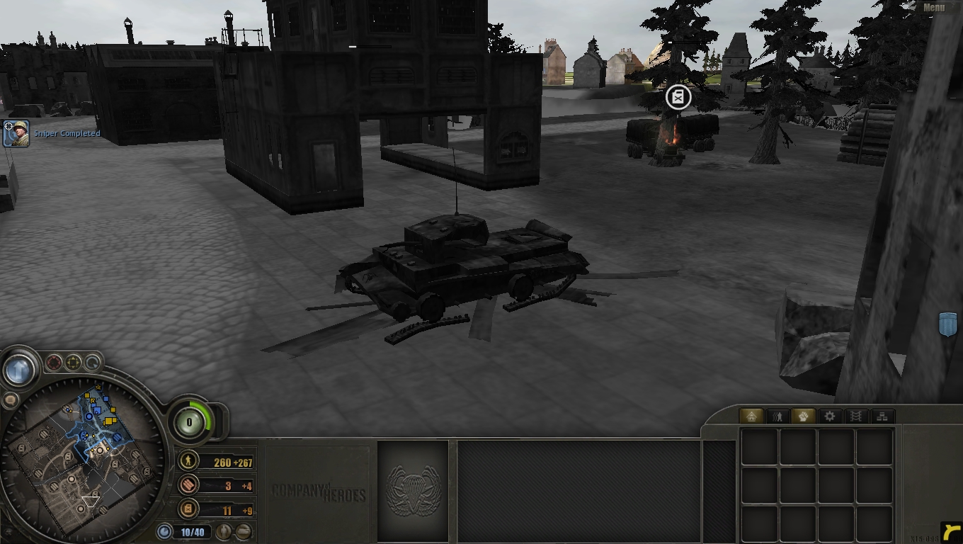

O.K., i've been trying for ages to access your website, and i finally got in! Thanks to the Skater At War guy, i was able to play your map, and i'd like to give you some advice:
Here is a list of issues i found with your map:
-Generic loading screen.
-No Victory Points.
-Strategic Points in statues.
-Needs more polish around bridges.
-There is a destroyed Cromwell.
That's all i noticed in my short time playing.

-> There is a destroyed Cromwell, O.o where ? can you post a screenshot ?

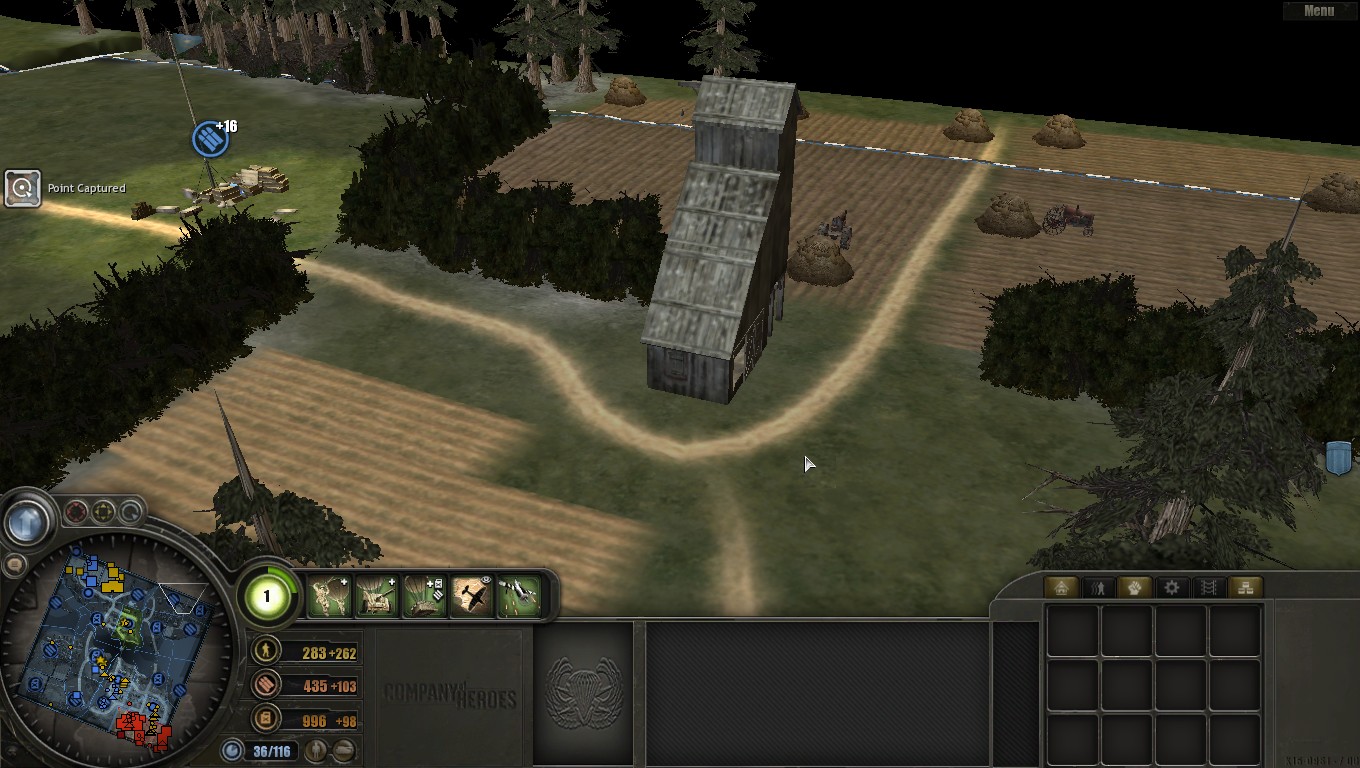

I noticed that 1 of the buildings seems to be in the wrong territory. It's hard to explain, so i'll see if i can take a screenshot of it, as well as the destroyed Cromwell.
Post Merge: [time]1295815955[/time]
The building is in the Munitions sector according to the game, but it's actually not.

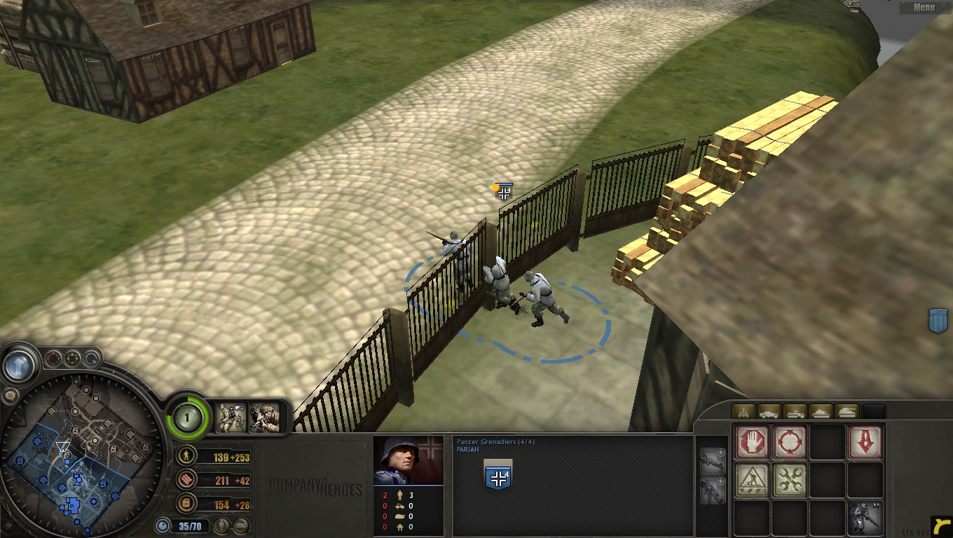

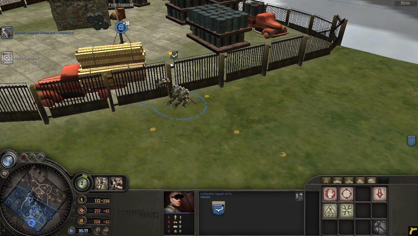

So, i found some issues with a fence around a Fuel point; Infantry can move through parts of it. And it looks weird how some parts are on a hill, making them stick up... And i also got a better shot of that annoying building that's in the wrong territory.

Ho Thx Pariah for a test =D !
i will changed that =)
#56324
Re: Perekop (6)
The fences look like VisOnly objects, @ElQuattro: which object is that? Change it to "ebps\environment\art_ambient\objects\walls\metal\iron_gate_l_01" when you want the fence to look like this.
VisOnly Objects are not for use on playable area, they are just for off map use because their physics don't need to be loaded. If there are further VisOnly objects on your map, please replace them with their real counterparts if needed ;)

The building appears to be on empty territory or isolated territory, that belongs to the neighbour munition point, maybe he forgot to paint the territory beneath the building.
You have to imagine it like this: First, you place the munition/fuel/strategical points. Then you choose the TER (territory) tool and select "Calculate Voronoi" which creates territory around the points. The problem of this game-generated sectors is, that their size and shape is equal to the other ones, it doesn't create any strategical or map-orientated territories. To change this, you have to paint the territory by clicking on "sample" and choose the territory you wish to edit.
Because the building hides the spot beneath itself, he might have overlooked it if the area on which the building stands was part of the calculated munitions territory before.

Yeah, that's likely what happened... (Still yet to really play around with territory in the World Builder.)

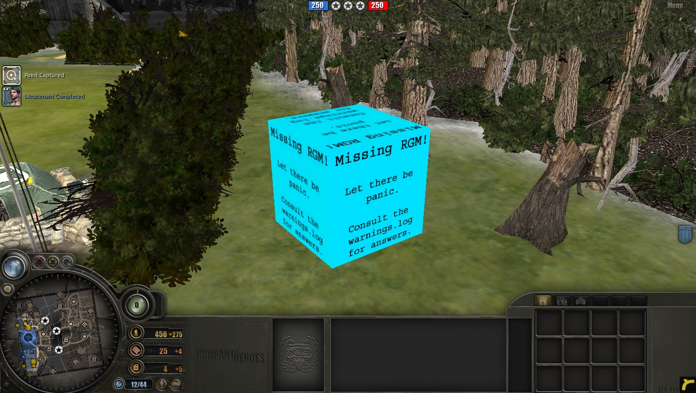

Well, i decided to have a quick (250 point) game to test it, and i found a few more issues. First of all, the border really doesn't look right. I realize the borders never look good, but i still think it could be better...
Also, there's some cyan box that doesn't appear to be historically accurate...
This box is caused by a missing RGM, a CoH model file.

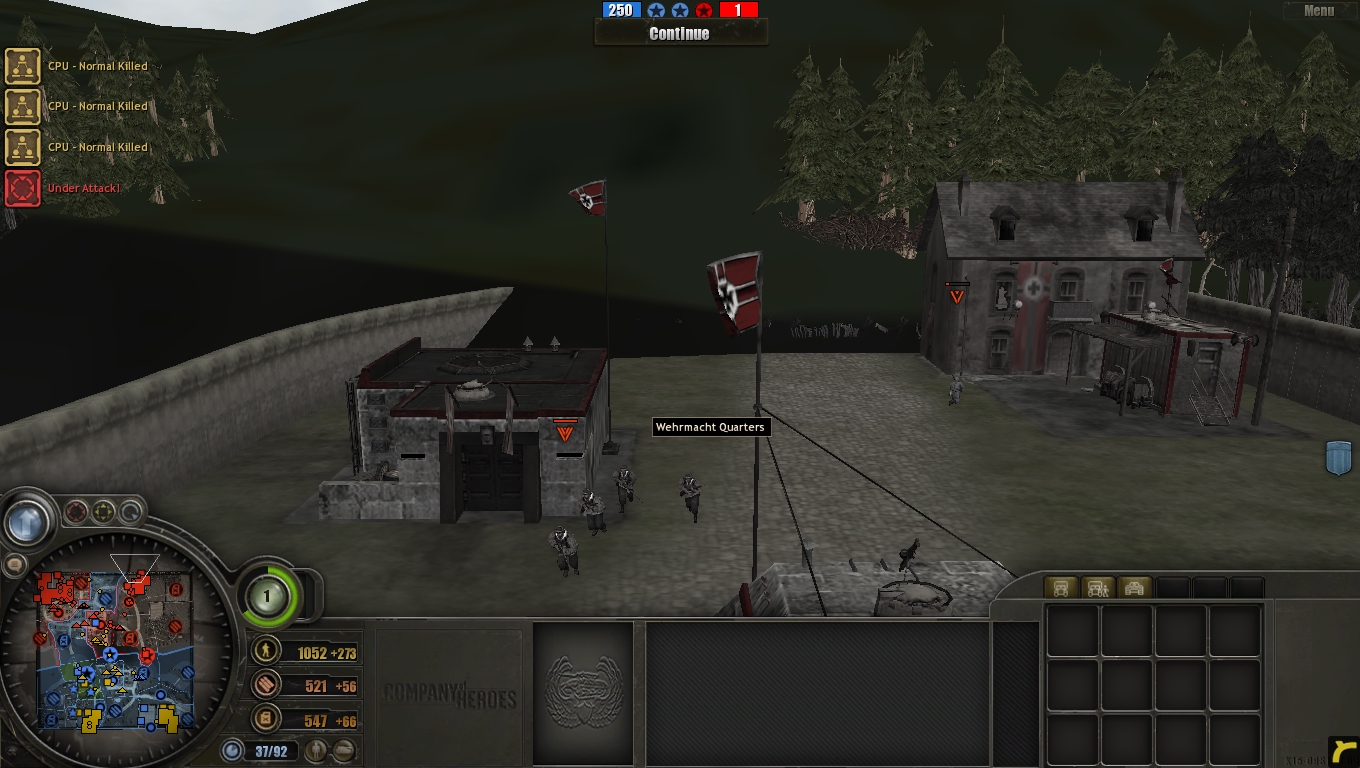

One thing that's also causing my attention is the off-map area again.
Like it seems, you just have adjusted a horizon mesh, that looks rather.. not that good.
If you would like to improve your off map area, you will have to stamp the whole map with the stamptool, which doesn't work in the newest version of CoH, but there is a fix for it. Just ask me, I will give it to you.

hi hi hi Friend =) !
My road aren't painted. I use spine texture and painted for random visual.
I've more problem with off-map area (because there is too small).
If you have a fix for it... i need ^^.
I will post a new version map, with more detail...
I've a problem with loading screen. I can not fix it :(
