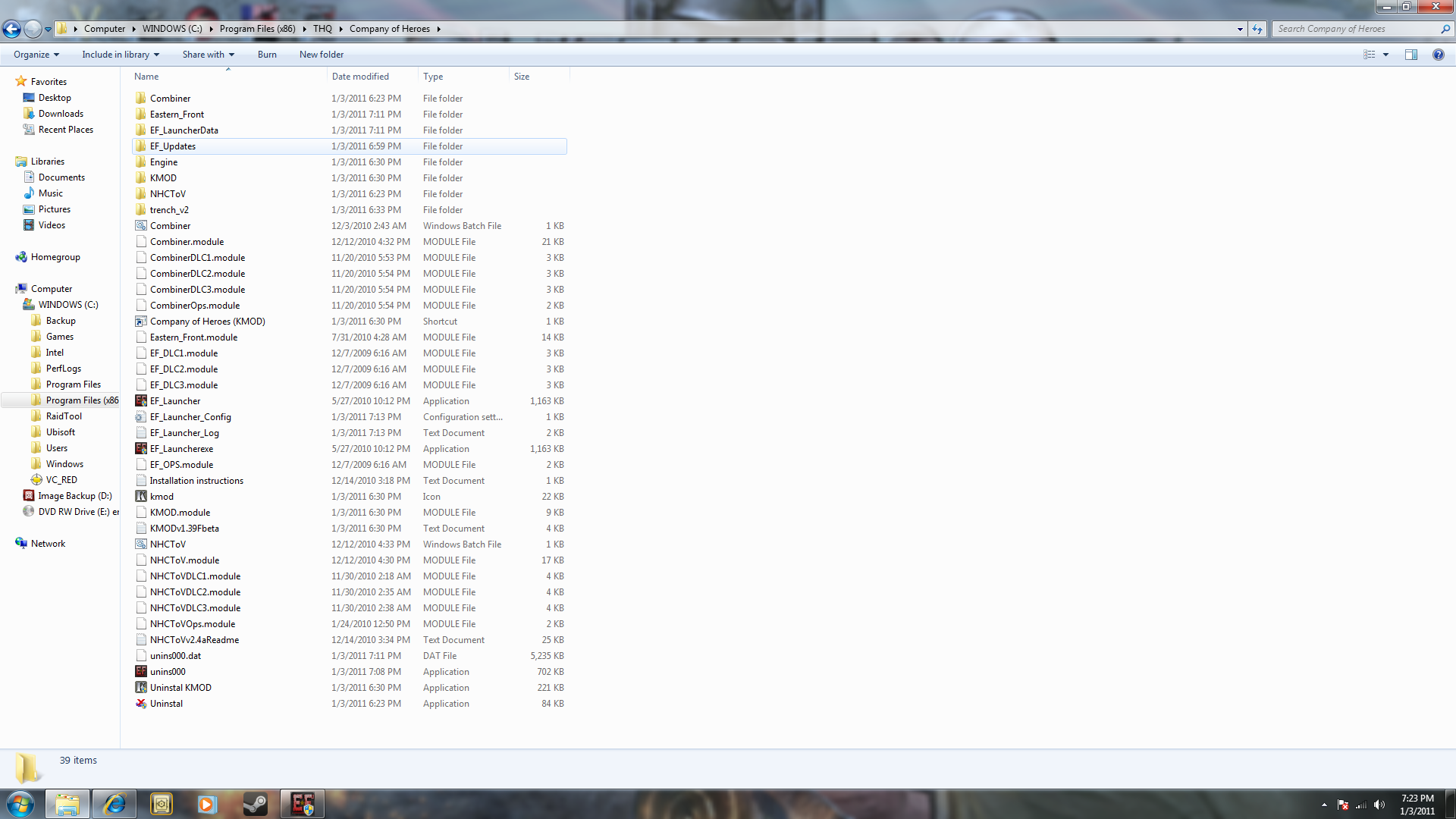

Could you post a screenshot of your CoH directory?

Hit prntScr key on the directory, then open paint and paste it.

here it is i think

#53816
Re: wont play
Yeah, that is. I can see EF files, but i fail to see CoH ones.
You need at least one CoH game (vCoH, OF or ToV) in order to run EF.

i have coh the first one and opposing fronts
#53818
Re: wont play
But there isn't a CoH file there. You need to install EF over CoH. Eastern Front isn't a stand alone game, is a mod from Company of Heroes.
