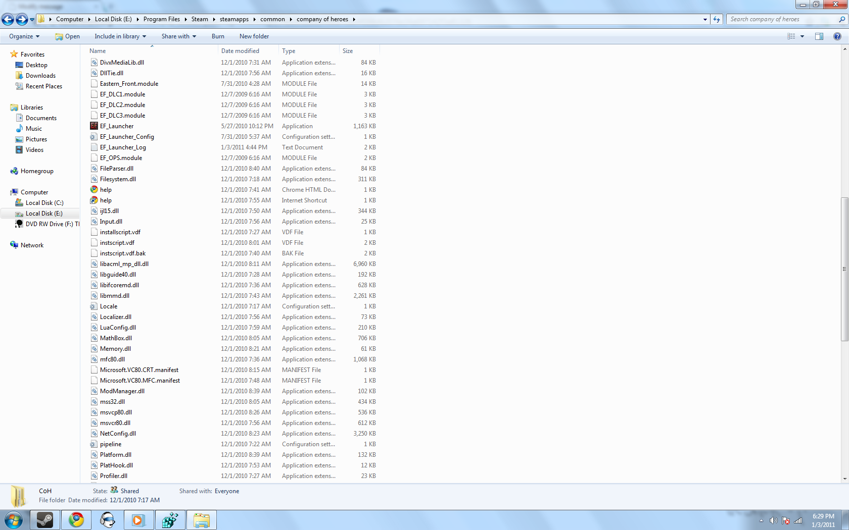

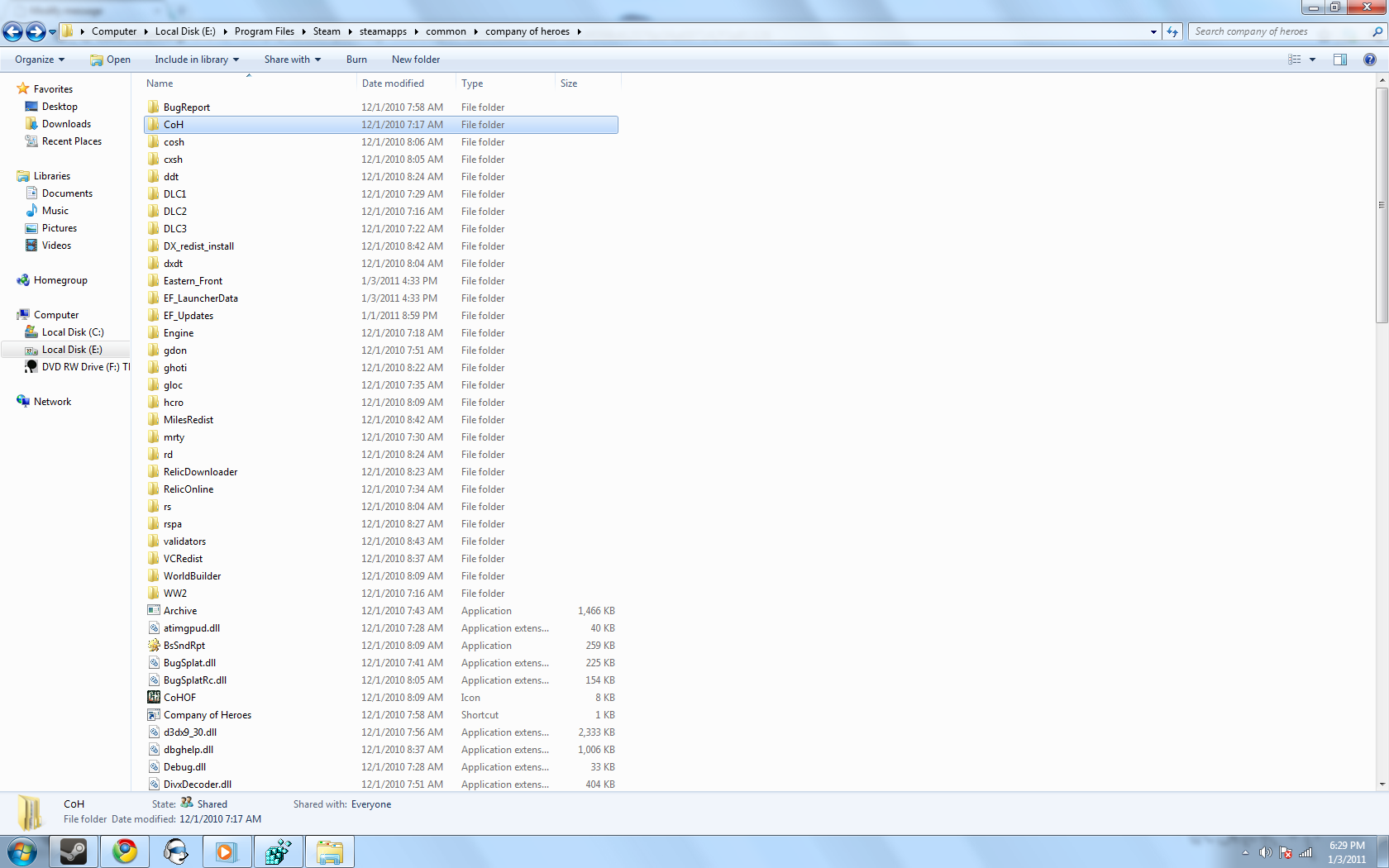

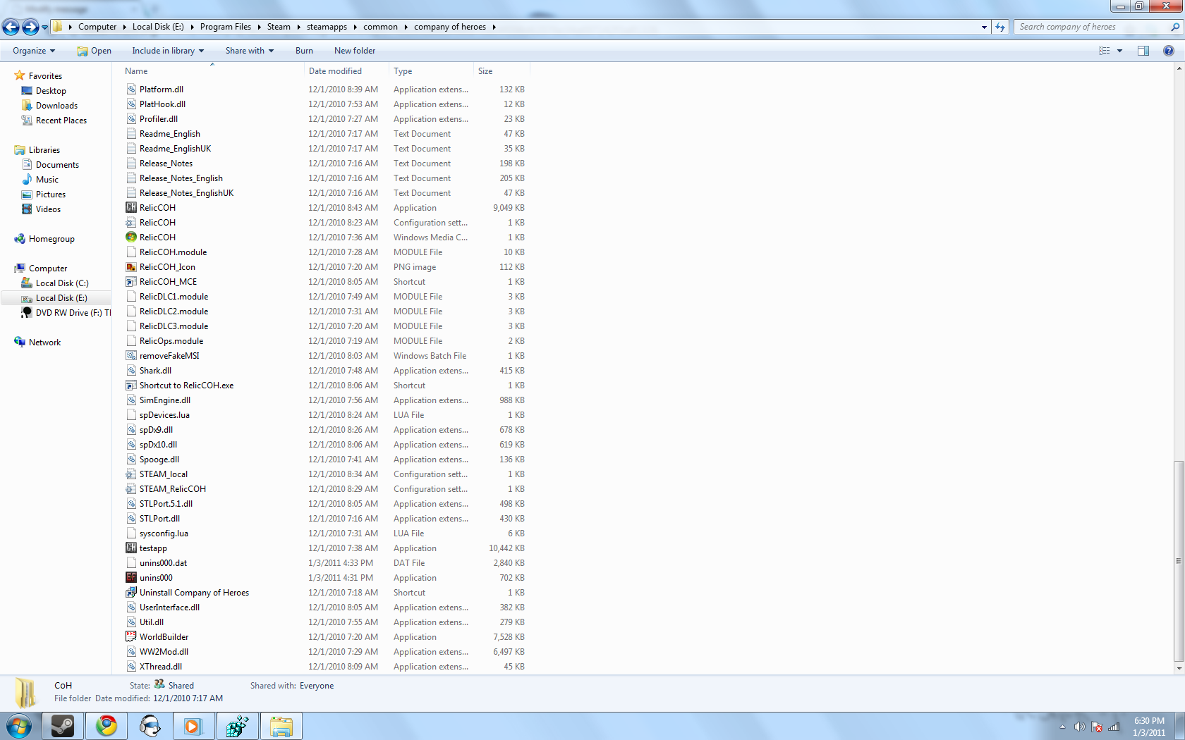

could you post an screenshot of you CoH directory?
#53828
Re: When I press "play game" it doesn't start
here ya go
#53829
i was talking about a screenshot of the directory on the explorer(c:\program files...) :).

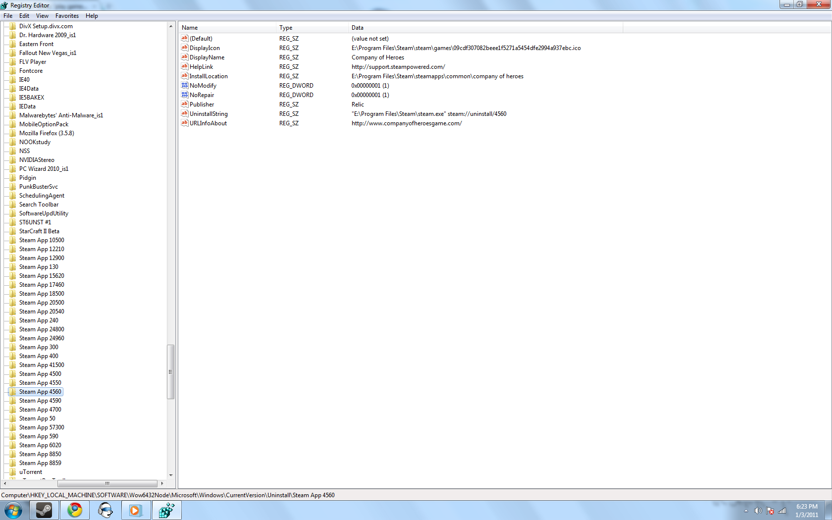

But now you mention it, could you check if your Company of Heroes registry have the correct InstallLocation?
You shouldn't have problems finding it, it's on the same level than App4560.

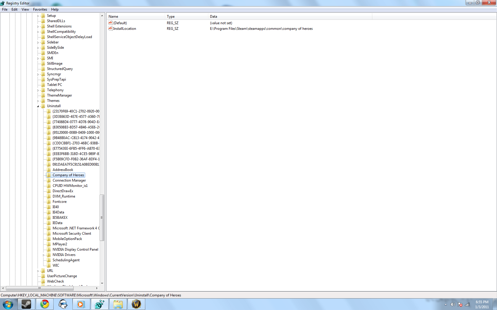

yeah i realized that after i posted that wasnt what you were asking for... Hopefully this is. and the InstallLocation says its: E:\Program Files\Steam\steamapps\common\company of heroes now if thats not it then i dont know how to find it/ dont see another company of heroes folder to go to.
#53831
Your directory looks fine, could you post two more screenshots?
One from this key:
HKEY_LOCAL_MACHINE\SOFTWARE\Microsoft\Windows\CurrentVersion\Uninstall\{97AFD0D8-5720-4A59-BFDC-CB92A36FADF9}_is1
and the other from this:
HKEY_LOCAL_MACHINE\SOFTWARE\Microsoft\Windows\CurrentVersion\Uninstall\Company of Heroes
#53832
there isnt one for the first folder, but here is the 2nd one you wanted

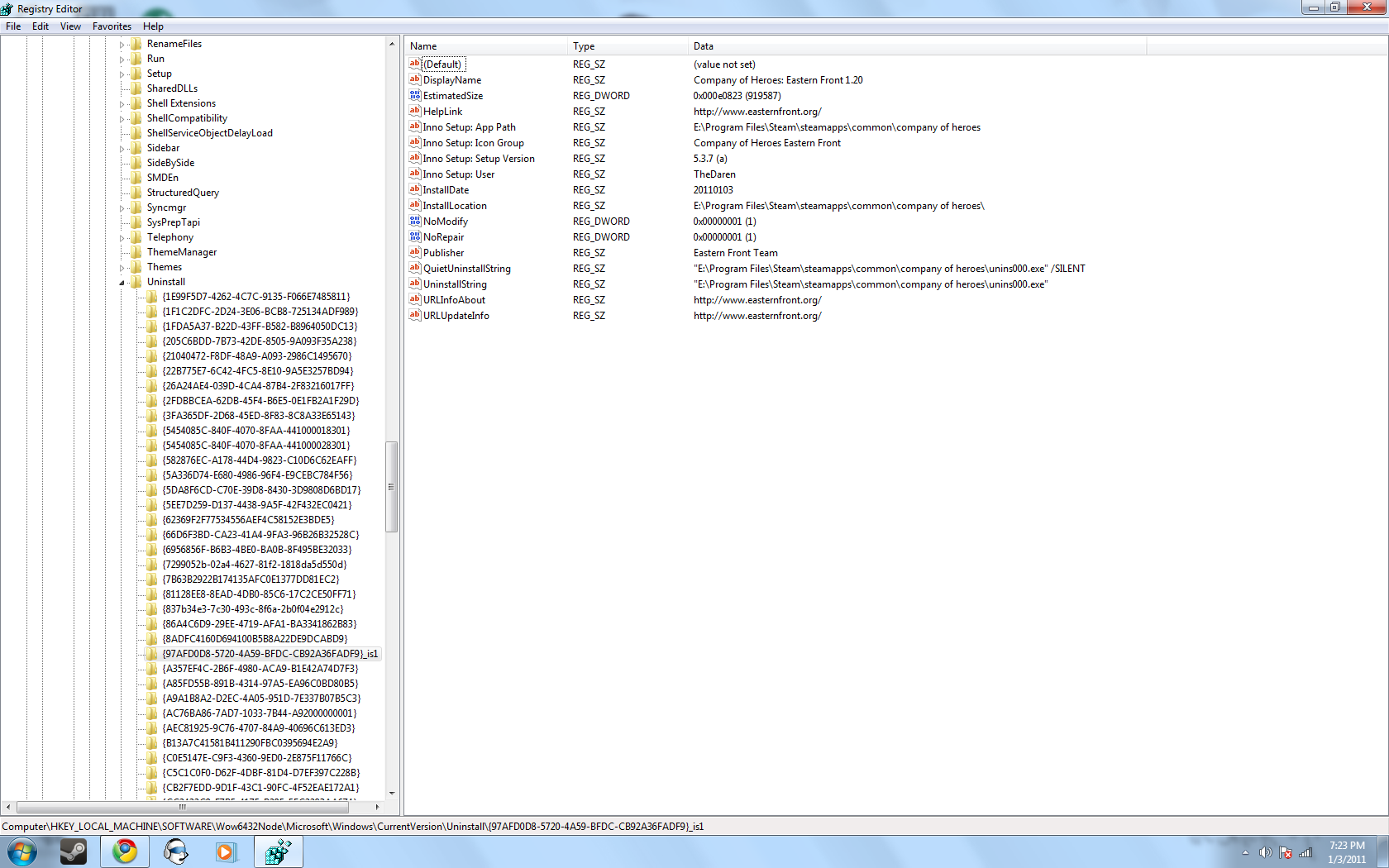

Are you sure? Please reinstall Eastern Front if that registry doesn't exists.
#53839
i reinstalled it, and diddnt find it under the path you gave me but i did find it under HKEY_LOCAL_MACHINE\SOFTWARE\Wow6432Node\Microsoft\Windows\CurrentVersion\Uninstall\{97AFD0D8-5720-4A59-BFDC-CB92A36FADF9}_is1. here is a screenshot of it.
#53841
Ok, i didn't know you use Windows 7 x64. Use this file.
