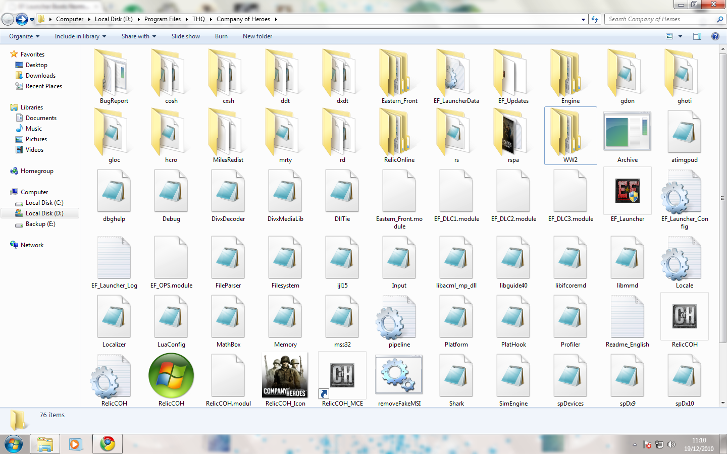

Re: EF Launcher Boots Normal COH
Here is a picture of my COH directory. I'm not sure if I have all of the files in the right places or something. If need more pictures or any information I'll try and help.
In the part of the picture you can't see is just the uninstall files.
Thanks for replying so quickly before.
#52928
So you can't play with soviets and in the main menu Danko(the soviet commissar) doesn't appear.
Could you run EF from the launcher, exit the game and upload the warnings.log file here(located at Documents\My games\Company of Heroes).
Also you can try to reinstall EF to see if it helps.
Do you downloaded the installer from ModDB? If not please post the link where you downloaded the installer.

#54016
Check this thread:
http://easternfront.org/forums/index.php?topic=1677.0
There says your error is caused by using an older patch than 2.500 and looks that you have 2.101(Opposing Fronts). Please make sure your Company of Heroes is up to date(2.601).
