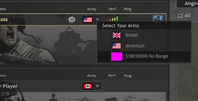

EDIT: another problem, ok, i installed them from directory u gaved me, path was ok, but then i turn on game, look what i get (attached file)

Re: Cant play mp
What language do you selected on the EF Launcher?

Re: Cant play mp
english

Re: Cant play mp
Could you check and post the MD5 checksum of your EF v1.20 installer?
I have a hunch about your installer being corrupted. You should download it again.
