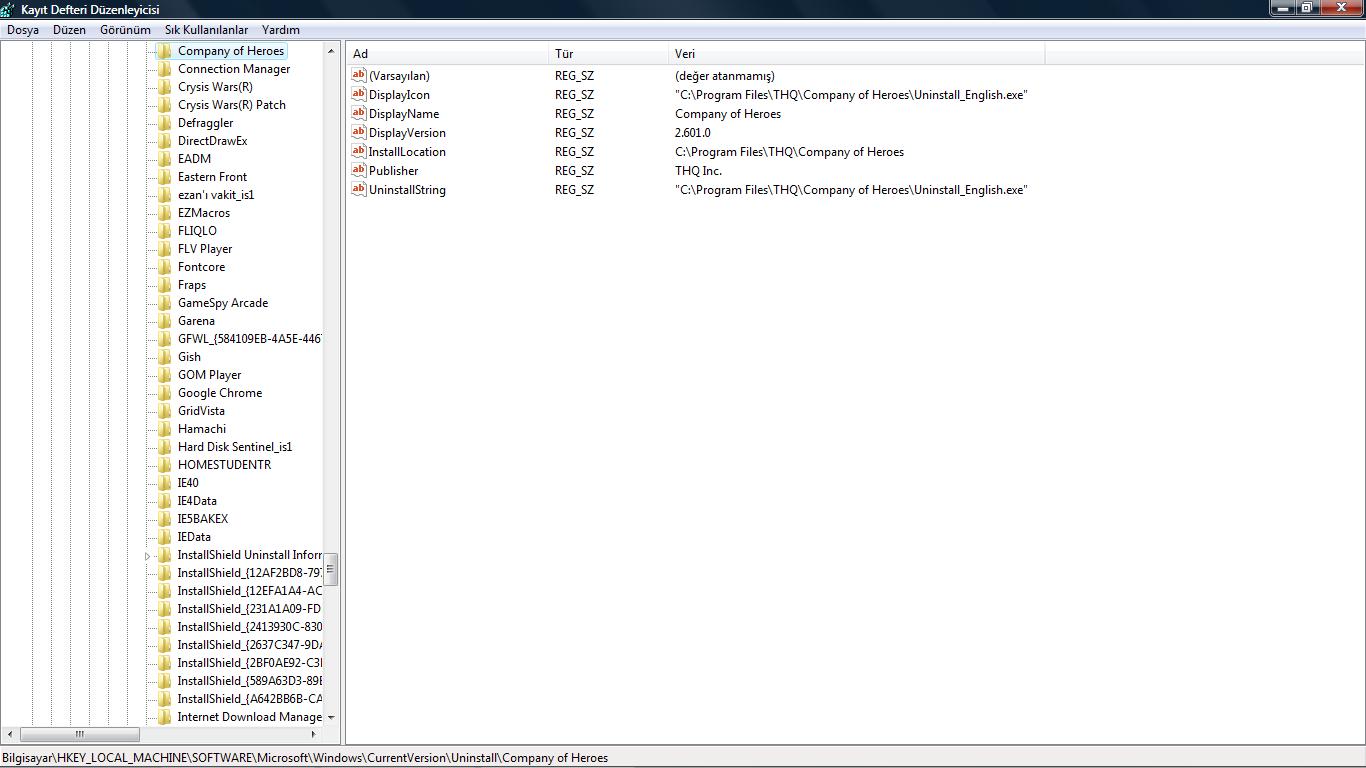

If you don't have a 64 bits OS, you should not be looking in that path. Look in "HKEY_LOCAL_MACHINE\SOFTWARE\Microsoft\Windows\CurrentVersion\Uninstall\Company of Heroes".

My OS is 32bit and here is regedit screenshot about CoH registry.

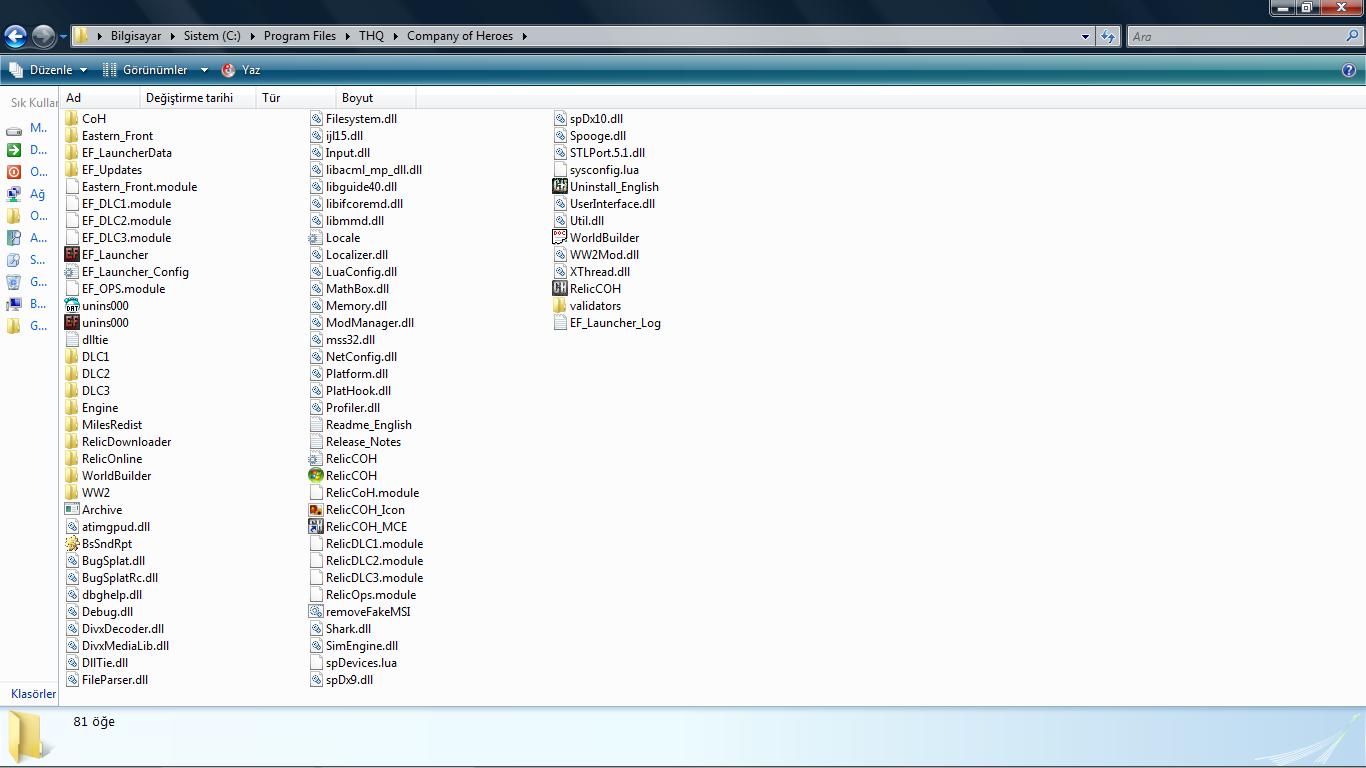

Did you run the game with admin rights? Could you post an screenshot of your Company of Heroes directory?

I ran the game as an administrator but same error  :(
CoH folder screenshot attached.

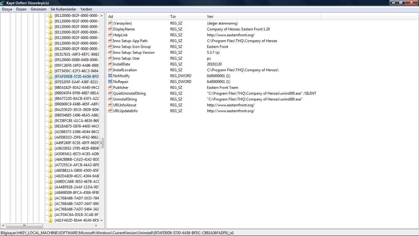

Could you post an screenshot of regedit's path HKEY_LOCAL_MACHINE\SOFTWARE\Microsoft\Windows\CurrentVersion\Uninstall\{97AFD0D8-5720-4A59-BFDC-CB92A36FADF9}_is1??

Re: Unable to locate CoH directory
Here.
