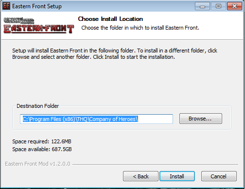

If EF_Launcher.exe it's not located it didn't install correctly. It should be on CoH Directory. Could you post a screnshot of the path where you installed EF?

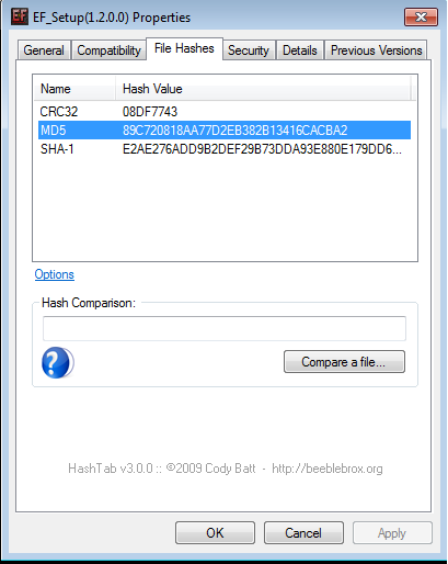

Check the integrity of the Installer. You can use HashTab.
MD5 of 1.20 Installer: 9AF7A662DCED463B051FE22539F851E0

Install Directory:

And Hash Results:
And yes, I have full adminstrative rights.

The hash isn't the same unless I had the wrong hash... but my version works so...

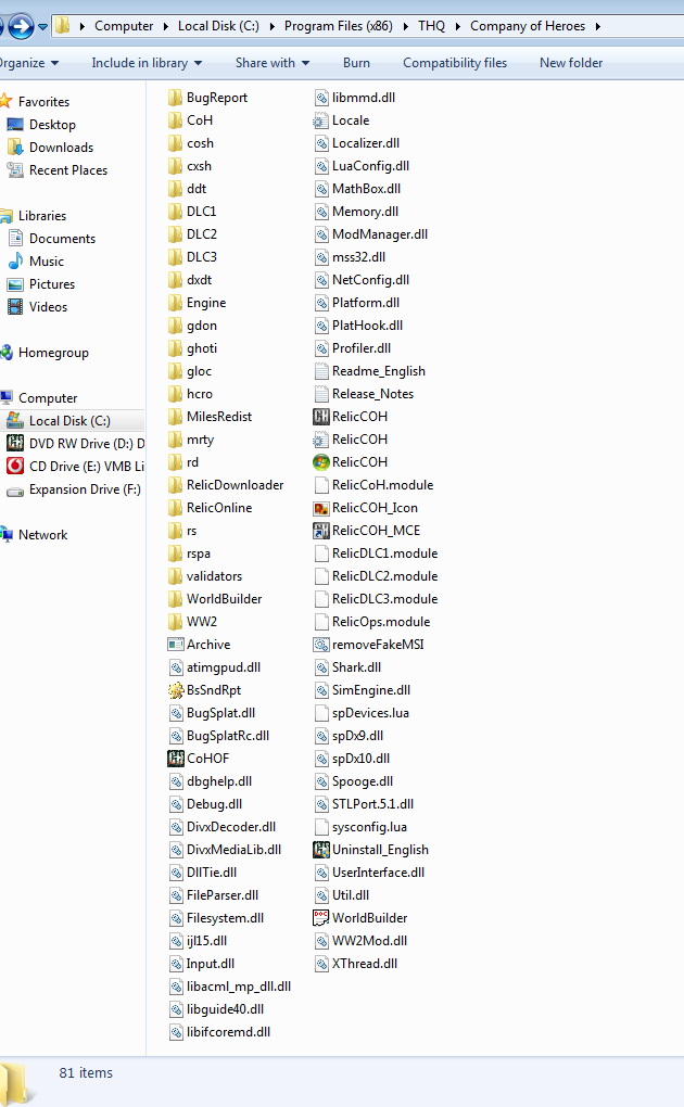

Also, could you post a screenshot of your CoH Directory?

Sure, here's my directory:

Alright: downloader didn't work. Same problems. MD5 the exact same as well.

That link should be dead, I'm gonna take and investigate that.
Edit:
That's the patch file ([IP address redacted] - [IP address redacted]), not the full version. That's why. Updating thread.
