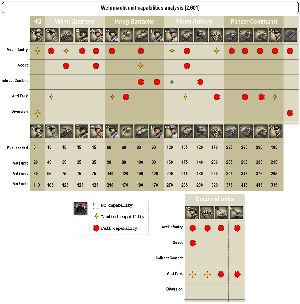

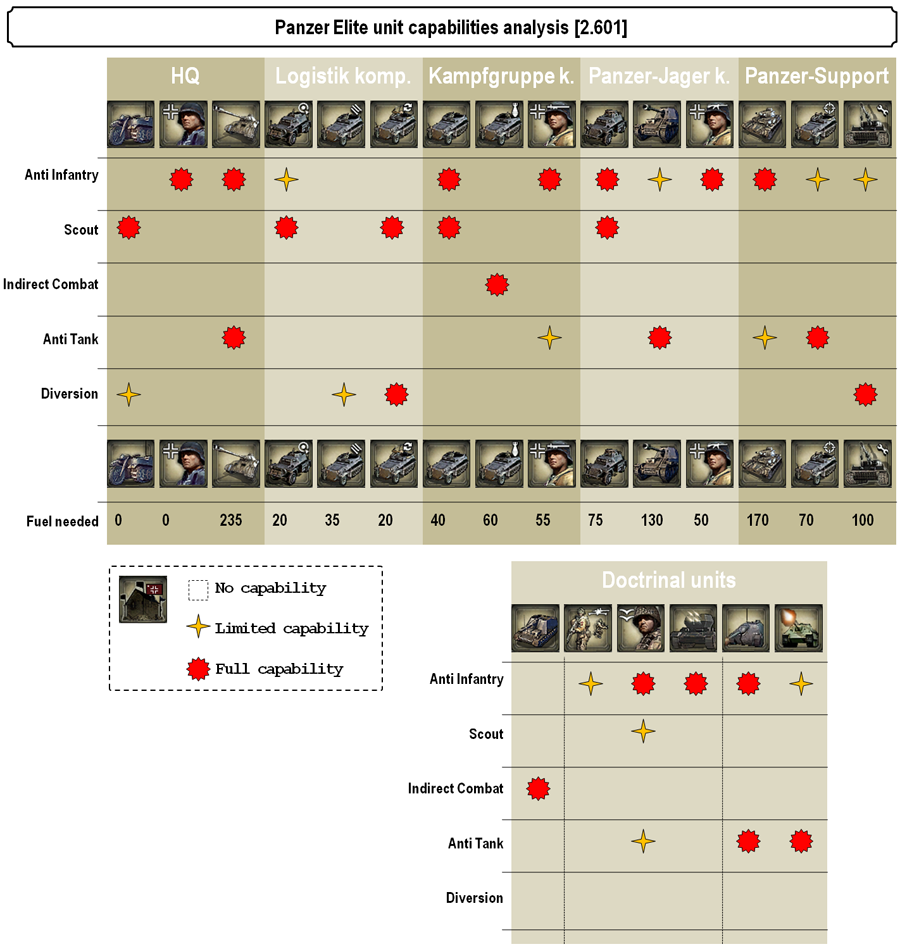

The result is attached to this post, I made Soviet, *Wehr and PE units analysis. Same could be done also for Brit and US, and for Ostheer concepts too :)

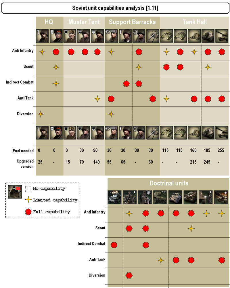

Here's the Soviet chart:
I.  Soviet tech
The main problems are the upgrades in Support Barracks and in Tank Hall. Soviet player really doesn't have to decide very hard which option to choose because the unlocked units cover wide variety of combat roles, mainly AT capability. This means either he choose Close or Medium range support he will have quite versatile units available. And same apply to Light or Heavy Tankovy upgrades. Result is that with few units available players tend to spam only those units then and not research another upgrades. It practically force player to spam only 1-2 units, which are available.
Another thing is Command squad which is now obligation to get for Soviet (there's simple no choice on that).
My proposal is following:
HQ and Command squad - as I mentioned, now the Soviet doesn't really have any option on this - he just must build one Commander. To add a tactical diversity I propose Soviet player to start with 25 Fuel and Command squad cost + Support barracks cost increase to 25 Fuel too. This way player will have 2 options what to build in the beginning of the game - either Support barracks or Command squad. Fuel cost for Commander could represent that he needs to move with his staff from Moscow to battle area. Btw this is the idea of Paciat and I think very good idea and I support it.
Support Barracks - should have 2 upgrades: Support units and Specialist training. As it is clear from analysis, Support units upgrade will give player possibility to build support units only - meaning with only 1 actual role in game (Mortar and AT gun). On the other hand Specialist training will give player more versatile units but for higher price (Sniper and PTRD teams). Again player will have to decide tactically what to get, either cheaper upgrade but less versatility or more expensive one but with bigger possibilities.
Tank Hall - should have 2 options too: Light tankovy upgrade and Medium tankovy upgrade, but exactly according to their names should unlock only light tanks (T70/90) or medium tanks (T34, Su85).  This should be player's another tactical decision if stick to quick light vehicles or wait and get medium tanks later. The situation now is that Soviet player really doesn't have to think about the upgrades because he will not make any mistake - with Light tankovy upgrade he gets fast vehicles and mobile AT gun too. Getting both Tankovy upgrades should unlock IS2 then.
Rest of the tech mechanics could remain the same (Strelky and Guards availability).
*Note to Wehr analysis: Wehrmacht unit availability (in terms of fuel cost) could be misleading becasue here is displayed only shortest possible route. Usually also lower tier buildings are needed to keep battlefield presence. Also Wehr veterancy means that all present and new produced units will have it.

As such I think it would be fair for me to explain why I made the teching the way I did.
Let's start with the support barracks. The most straight forward way would have been to split them AT/AI units,yes. However, doing that would effectively mean you'd need twice the researches to get Tier2, and you would definitely need to make both of them because Tier2 for WH/PE bring armour and strong infantry. So, what's the point in having two seperate researches when you actually have make both of them. Its hardly a true option. Remember that Soviet infantry are not the us riflemen all rounders with Bars and stickies. Their support units are a must have unlike 30cal/US mortar.
By splitting them the way I have now,it means you don't really have to make both researches and can move on to tier3. This makes for more flexible teching.
For Tank hull, we used to have it so that you would tech up to T70/90 and then at Tier3 get T34/SU.
99% of people always saved the fuel to get the T34/SU and never made the T70/90 because by that time they needed both AT and AI. By attaching the SU to the T70/90 you have something equivalent to WH tier3. This makes it far more attractive and you can forgo getting T34s alltogether depending on doctrine choice etc.
The SU is the soviet equivalent for the stug, except that its very fragile(3 pak shots kill it, like an M8 and is more vulnerable to shreks), more expensive, better vs vehicles and worse vs Infantry.
We have now tweaked the pricing of the teching further ensuring that T70/90/SU hit the field at the same time as Pumas/Stugs. Splitting them as described would reduce tactical diversity rather than increase it, which is why i've opted for the current system. We've also made it so that it requires both researches in the tank hull to get the IS2 increasing the time it takes to get it on the field considerably.
As for the command squad, we want it as a 'must have core hero unit' which is essential to the Soviet flavour. The idea is that they vet up and gain abilities while the faction techs up. You can't really have an infantry unit costing fuel either.
I hope that clears it up more
Thank you for the explanation. Sometimes I wonder what is the reason behind some upgrades/units in EF and your post unveil some of those points. However I must add my remarks too, I hope you understand that they're valid... at least to some point :)
First Support Barracks, this is misunderstanding - I do not propose to separate AI units from AT. As I wrote - the reason is to separate one role units from mulitiple role units. Because in my suggestion you either have cheaper upgrade giving Mortar (AI) and AT gun (AT) or more expensive upgrade which delays further tech to Tank Hall giving Sniper (AI) and PTRD teams (AT). Both Sniper and PTRD could be then used to other army roles, Sniper could call arty and PTRD could fight infantry to some point and lay mines. That is why they should be in multirole group, they're more versatile units. Also researching one Support Barracks upgrade will unlock the Strelky so Soviet will have some solid force to fight in middle game.

QuoteI understand your point. The problem is that now it is same situation (at least in 1v1 or even 2v2) - no one ever bothers to tech T34, everybody is getting fast T90+Su85 combo. Again as I tried to show in my analysis - Soviet will get pretty decent package including good AI and AT at same time.
I believe this is related to the current low fuel cost of both the units and of the upgrade, not the fact that you get the SU. If you go for these at the moment, they come a bit too early and too easily, hence why its a favored tactic. That will change with the amended costs. The fact remains that you get fragile tanks with this upgrade, where as with teh T34s you get resilient tanks. Also the change to get the IS2 will also make a difference as its not an easy fall back move any more.
PTRDs are specialist AT unit, they're being tweaked as well so they're not good at all vs infantry really but get a bit better vs vehicles. They no longer have normal mines.
QuoteMy guess Light tankovy upgrade should be available about +30 Fuel later than it is now.
A good guess  ;)
You'll have to wait and see all the changes....as we're still working on all the stuff
