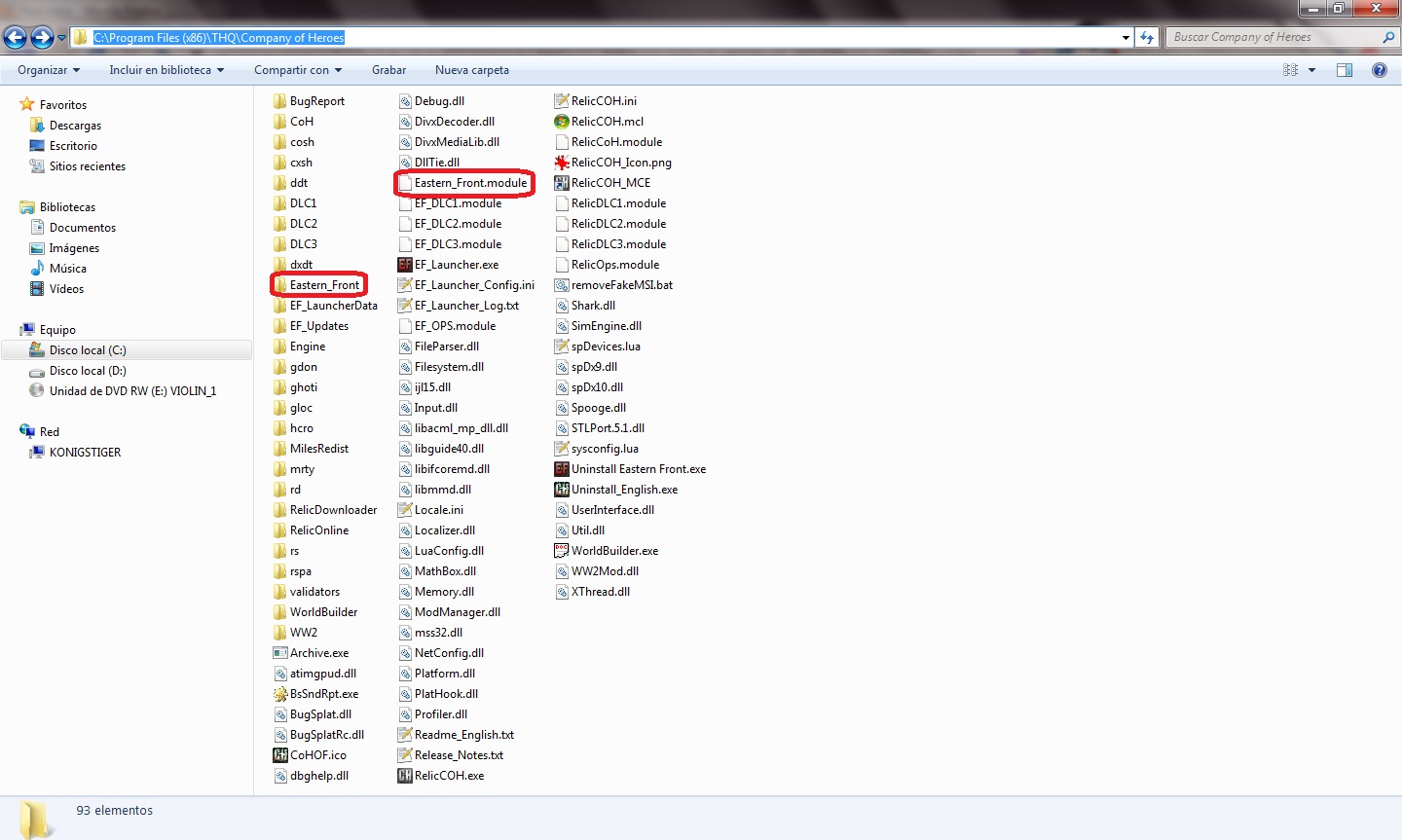

Check that you installed EF in the same path as CoH, not in any self-created folder. I.E. My CoH path is:
C.\Program Files (x86)\THQ\Company of Heroes
my EF path will be the same. That error happens because RelicCoH.exe can't find Eastern Front files.

Thanks to blackbishop I was having the same problem. You don't have to uninstall and reinstall. All I did was cut and paste and the game was running.
