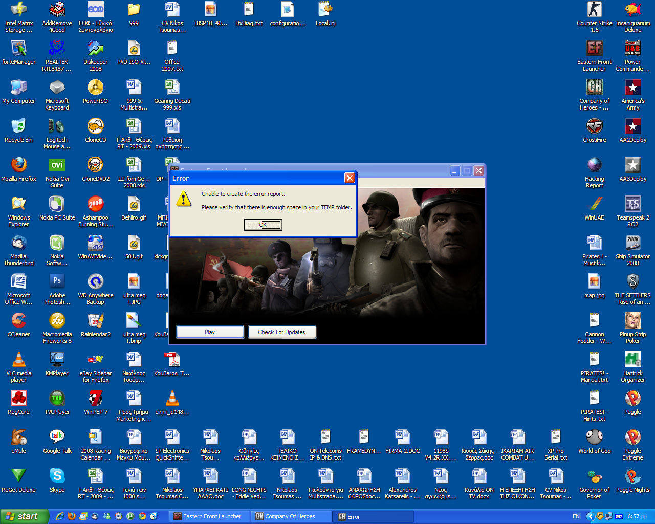

Following your suggestion, I'm making a new topic about the crashes I experience with EFv1.1
As i said, have never had EF crash before, it only happened after i updated to v1.1. Actually the game only crashed after quite some times i tried to load/play the Zhytomyr map on a skirmish. The set up was just me playing PE and the AI playing the Russian Army.
After preesing the "start" button, the screen changed normaly to the loading screen where it starts filling that "loading bar" up to approximately 80-90% and then i get an error (see the screen shot), to view the error message i have to Alt-Tab to it and to unlock the game i have to manually end it via the Task Manager.
See the uploaded files as per your request. I hope you can trace the error down and suggets/provide a solution  :-[
Thanks in advance,
Doc

I'll gladly do that.
But please can you explain in which directory is theat "temp" folder ? Cause I don't even get a "bug report" after the crash (see my previous screebshot to see what i get after the game crashes/freezes)
WIll upload the files as soon as I know where and how to find them.
Doc

Click Windows + R and enter %appdata% (with the %)
Then it's under one of the subfolders (Vista/Win 7 is Local/Temp).

Actually, I found out that you can enter %temp% instead.

Ok i just replicated the exact same crash as i have described it in my first post in this thread.
Map Zhytomyr, skirmish, me playing PE and an AI playing the Russians. Again i got the same error while still on the loading screen before even getting into the game map.
See below the uploaded files. As far as the dump file, I wasn't able to find one in the Temp folder, instead I found a file named "bugsplat.log" (see below) and seems to be the one you might need.
I'm really frustrated....  :-[ and will wait anxiously for your response.
P.S: I also had another crash before the one I stated aboove. It happened on Rostov map, 3v3 all humans (2 WE 1 PE and 3 Russinas), game crashed (screen frozen) a few seconds after my Jagdpanther entered the map.

ow, yah, you posted in the first page "temp is full" or something right? That's why you can't find anything. You could try to clean your temp folder.
Else, since this crash while load only occurs on Zhytomyr, just avoid it ;)
#35522
Re: EF v1.1 crashing
I had already emptied the temp folder but it did the same thing  :-[
Rizz wrote:Else, since this crash while load only occurs on Zhytomyr, just avoid it ;)
Will do a full fresh install of EF and see if it helps out.
