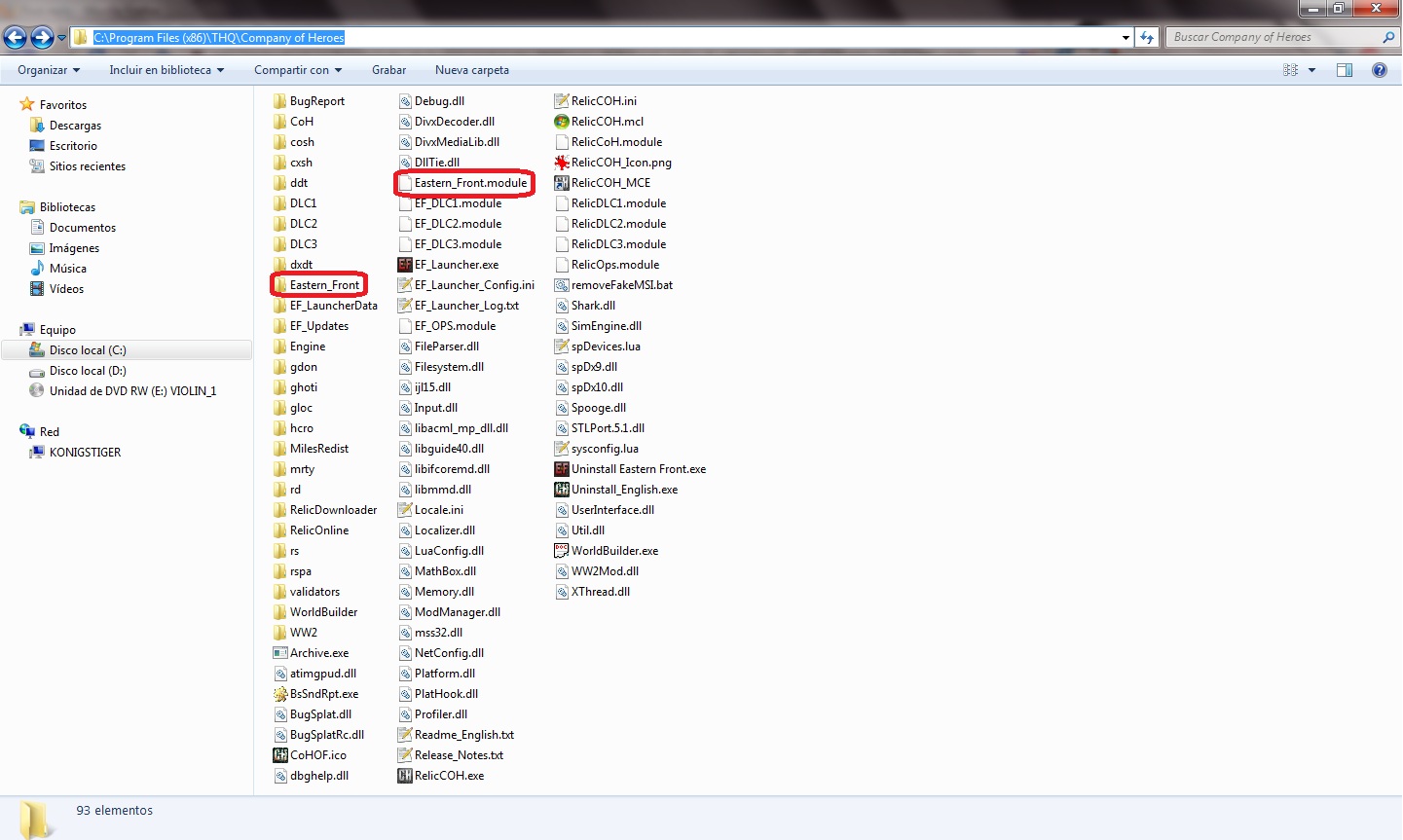

My path is, ignoring the "(x86)" because i use x86 64...
C:\Program Files (x86)\THQ\Company of Heroes
and then over that directory i have Eastern_Front.module and Eastern Front folder, I attach a screenshot. My OS is in spanish but that should be enough ;D.
#35670
Re: ef just sits there
You shouldn't have self-created folder, the Module file MUST be in the main CoH folder, and real Eastern_Front Folder MUST be in the main CoH folder.
