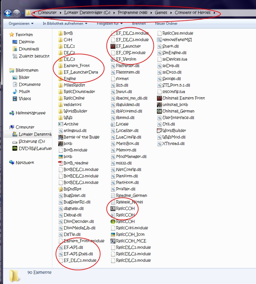

You must install CoH:EF into your main CoH Direct, not a subfolder. Make sure the Eastern_Front.module is in the same folder as RelicCoH.exe
#20107
Re: COH loads when I try to play EF
for example heres a screen  :) ... all ef files/folders next to the normal coh files/folders in your coh root directory...
