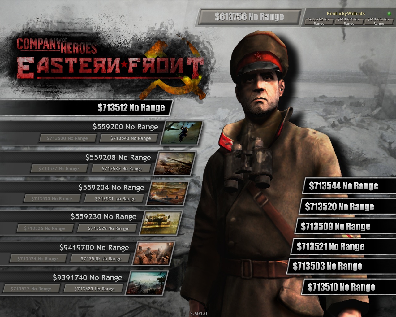

The game works fine for me, but I'm getting this.  Also, all in game buttons, xp, weapon damage, sector values, engine damage, etc.
I've reinstalled a couple times.
Thanks!

Re: $77900 No Range
Open the file called 'locale' in your CoH folder and copy-paste what is written there.

Re: $77900 No Range
What language are you using?
Also the local file is located in CoH/Engine/Local and Eastern_Front/Local

Re: $77900 No Range
English.
Tried copy-pasting the file Eastern_Front.English.ucs from the EF/Locale folder.  Then I found the Locale folder from COH, and tried that.  Still nothing.

Re: $77900 No Range
What files do you have in CoH/Engine/local ?

Re: $77900 No Range
Just the folder "English" with RelicCOH.English.ucs inside

Re: $77900 No Range
Do you have a file called 'locale.xxx' in the main CoH directory (forgot the extension), and what does it contain? Does it work with vanilla CoH?

Re: $77900 No Range
I have one called Locale that is just a notepad file containing:
[locale]
lang=English
And then another called localizer.dll
And COH was working fine yesterday

Re: $77900 No Range
This is very irregular, I'm not sure how you would fix this. I will look into it, but Rizz will most likely beat me to an answer  :P

Re: $77900 No Range
Fixed it!
Went into the COH properties, Local properties, and then verified local game files.  Now it's working.
Thanks for the help guys

Re: $77900 No Range
Sounds like he runs the game via steam. Open steam, right click Company of Heroes and go to Properties. Find the Local Files and then verify the integrity of the game cache.

Re: $77900 No Range
Sounds like this RelicCoH.English.Ucs was corrupted.
