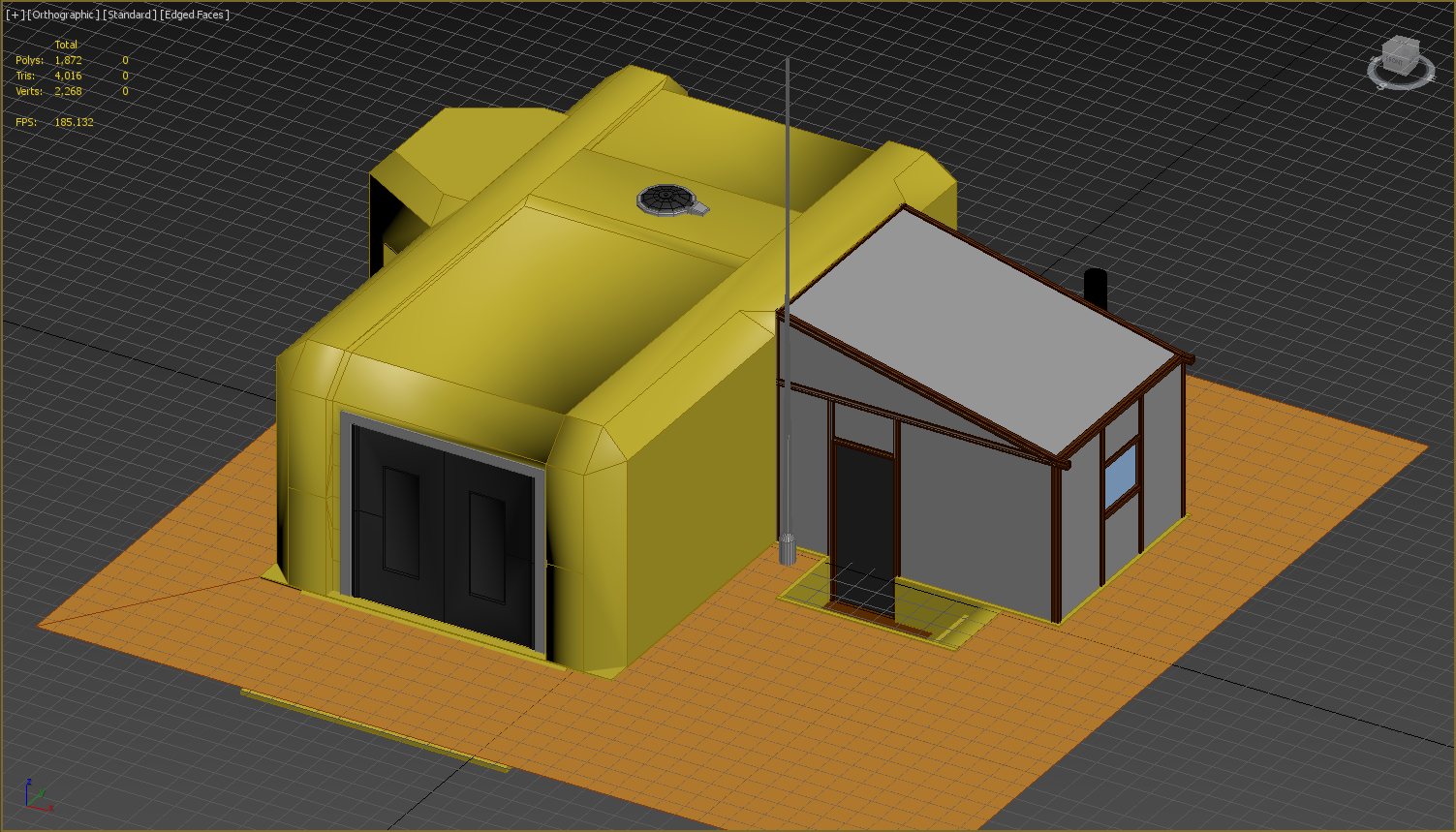

I've attached a an image of where I'm at right now - 1872, but some 'optimisation' still possible to bring that down. I'd like to add some more 'detailing' as yet though, maybe smooth of some edges a bit more, etc... Tried building a sandbag wall, but making actual sandbags and building the wall from there quickly caused my count to sky-rocket (Over 5k).
Anyway, any commentary/advice on the building would be much appreciated (including 'detailing' suggestions in particular).
As for the exportation process... I have 2 versions of 3DsMax on this computer already ('16 and '17)! And that's only because of the free student licence! I can't really go getting yet another! ...Thanks for the link though I guess... ^^;

That looks quiet nice. Only problem I currently have with it is, that you have an own "ground" plane and an extruded staircase. This won't work ingame, the only thing close to that are deforms, which are very imprecise. See this as a reference: http://www.moddb.com/mods/coheastern-front/images/new-armoury-building1#imagebox
You might also want to check out the CoH - Model importer. So you can use objects that are already textured and loaded instead of remodelling stuff (sandbags for example).
