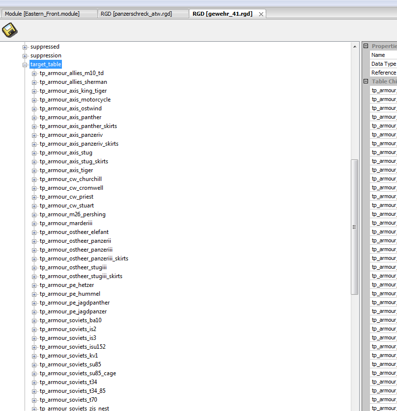

Well, thanks for the answer, but I can't find tp_armour_t34, or anything similar. I suspect the tens of meaningless types there (the ones like 0xF8B60D69) to be the tanks added by the mod , am i right? I look at landser_kar98 values and it has a damage modifier of 0.01 against all of them, so they are most probably tanks, but I am not sure.
EDIT: Thinking again, maybe I don't even need to seperate them, as I want Panzerfaust to be OP against all of them. I just need to know if they are tanks or not.

No. I was at work while I wrote the post, that's why I couldn't look up the exact location. The 0xF7DDDSA23 target tables are not used at all.
The armourtype from T34-76 is "tp_armour_soviets_t34", the one for the T34-85 is "tp_armour_soviets_t34_85".
Changes to this armourtype on any weapon has an effect on the T34 tanks.

Re: Some noob questions about modding(EDITED)
http://i.imgur.com/AoT1j8N.jpg
This is what I was talking about
There is no tp_armour_soviets on the table, just these.

Hmm .. strange. Mine looks different:
Dunno why tho xD

Well...  when you guys didn't answer for like 3 days, I went on and asked about it in the armoury of official forums. There, a senior member called celution said he was an ex-EF developer gave me a txt file including the translation of every 0x00059FDA-like code. It will be rather annoying but, I think I will be able to manage.
Thanks for everything!

Have you replaced the regular RGD_DIC.TXT in the "dictionaries" folder inside the Corsix Mod Studio folder you are using to mod? Otherwise it will show hex strings(0x00059FDA-like code) instead of the intended values(border_line_color_g).
If you have more than one Corsix MS folder, perhaps you are using the wrong one?

Well, thanks, I just thought of it before coming here one more time. I shouldve got it before though. I overwritten it, and tp_armour_soviets are now there. Though there are some more strings still, celution had told me it was a bit outdated.
