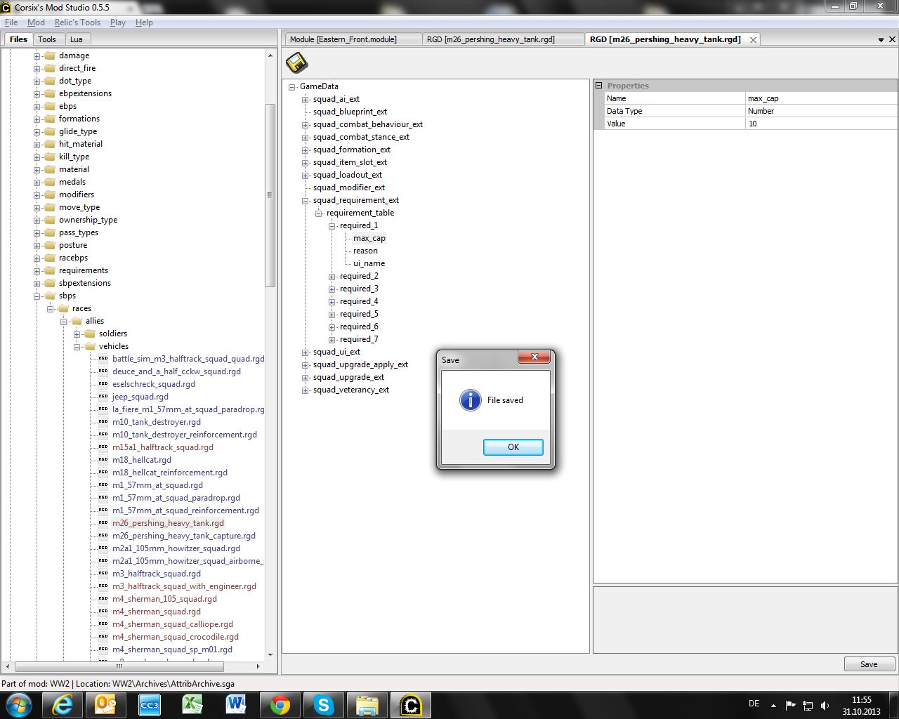

so I did the following
* loaded 'eastern_front.module' into Corsix
* changed to  attrib/attrib/sbps/races/allies/vehicles/m26_pershing_heavy_tank.rgd
* amended the value of 'squad_requirement_ext/requirement_table/required/max_cap from 2 to 10
* saved it
nothing happened ingame :(
could you please let me know what exactly needs to be amended?

@letsfetz
You didn't modify the right file. You can mod our mod but we don't offer support about it ;).
